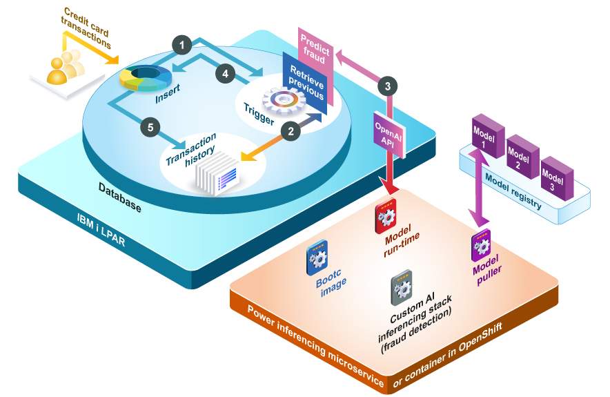

AI inference was enabled on IBM i by deploying models externally in a co-located Linux logical partition (LPAR) and integrating them through a Representational State Transfer (REST) API endpoint. The IBM i LPAR sends relevant information to the endpoint and receives the model’s prediction in response.
In this solution, a Long Short-Term Memory (LSTM) model is deployed on a Flask API in the Linux LPAR. An LSTM is a type of recurrent neural network (RNN) that is used to classify sequential data by learning long-term dependencies. On the IBM i side, a trigger is called before a new record is inserted into the IBM DB2 table (representing a credit card transaction). This trigger gathers the current transaction along with the six previous transactions for the same user and card combination, and sends this data to the inference endpoint. The LSTM model processes this sequence of seven transactions to make a prediction and then sends the result back to IBM i. The model looks at all the information that is provided by the seven transactions to assign a score (0-1) for the percentage of fraud likeliness for the singular input transaction. Then this “is-fraud” value is set for the corresponding column for in the before trigger, and inserted to the table in IBM i.
Architecture
As described earlier, the workload is run on two LPARs (Linux and IBM i).
Linux
The Linux LPAR contains the REST API endpoint where an LSTM model does inferencing with a sequence of seven credit card transactions to predict if the current transaction is fraudulent.
IBM i
The IBM i LPAR contains a database of credit card transactions. The schema contains the following database elements:
  • User-defined function (UDF)s: UDFs help to retrieve the previous six transactions for a given user and card. The UDF will be called in the trigger.
  • Trigger: Upon insert, the trigger creates a JSON document with the current transaction, as well as the previous six transactions for that user/card (this is done by calling the UDF). The JSON document is then sent to the REST API on the Linux LPAR to determine if the current transaction is fraud. The result is sent back to IBM i, which inserts the transaction into the database with the is_fraud value set.

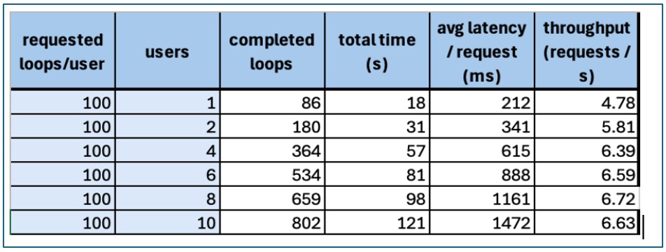

A series of tests were conducted using Apache JMeter to measure throughput and latency, varying the number of users. Each user made 100 requests.
Result of the tests conducted using Apache JMeter to measure throughput and latency, varying the number of users

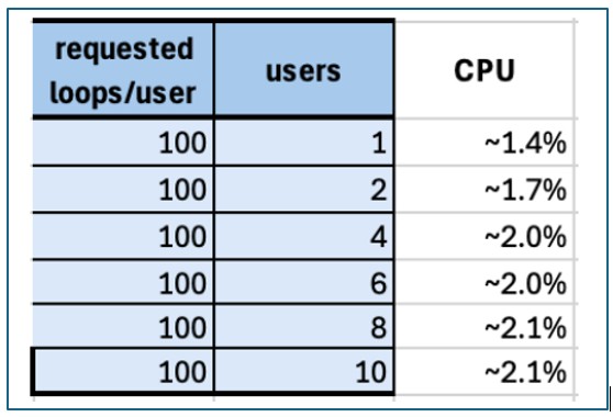

CPU utilization
The CPU utilization on the Linux LPAR remained very low despite the number of users (around 2%).
Time breakdown
When observing time breakdown, majority of the time is spent on the inference phase of the workload, indicating that the IBM i side is not the bottleneck. The two areas that remain constant in time regardless of the number of users are the model load time and the JSON data extraction time. The model is loaded globally, once at the initialization of the podman container, with a time of 90 ms on average. The JSON data extraction time averages at about 0.11ms. The two areas that notably increase in time with an increase in users are the data frame creation and inferencing. The data frame creation time increases by about 8% to12% per user while the inferencing time increases by about 15% to 20% per user.
Results and findings
The results above demonstrate that throughput remains relatively constant when increasing the number of users, highlighting a limitation of scaling. After this investigation, it was evident that the Flask endpoint was processing requests sequentially instead of concurrently, causing throughput to remain flat when increasing the number of users.
