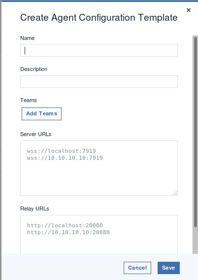

So how do we do this?  First, create an Agent Configuration Template by navigating to Resources > Agent Configuration Templates then click the Create Agent Configuration Template Button.  You should see a dialogue like this:
Give the template a name perhaps related to the firewall region the agent lives in or maybe data center.
In the Server URLs box make an entry for each of your servers URLs.
In the Relay URLs box enter a list of the relays you want a group of agents to connect through and then click Save.
Note: I found that if you try to specify https then you get this error:
Please correct the following errors before submitting this form:
Invalid hostname: https://myrelay:20080
The problem is not the hostname, but the protocol.  You can only specify http.  The agent communications using web sockets have their own end-to-end encryption with the server so the relay can't read the traffic, they just forward it on.  So this isn't a reduction in security it also removed the need for the mutual authentication setup for JMS.

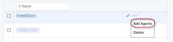

Alternatively, you can bulk add agents to the template on the templates screen by clicking the … option next to the template name and selecting Add Agents.
You can filter the list of agents by typing a partial name then the drop-down list is reduced.
