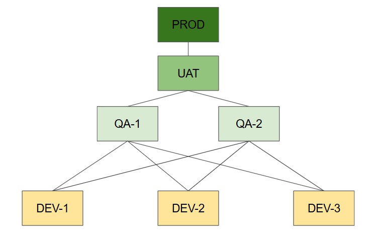

Figure-1: An example of  hierarchy structure of environments
From the “route-to-prod” path that we see in Figure-1, if we want to promote the Feature-A from  DEV-1 to QA-1, we perform the install in QA-1 and uninstall from DEV-1. So, the obvious question is how to ensure that we uninstall from the right DEV environments? This is the topic we discuss in this blog.

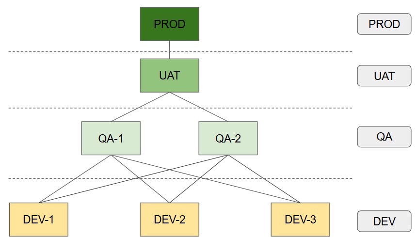

First, we categorize environments into several stages, in this case DEV, QA, UAT and PROD are the different stages for the hierarchy of environments shown in Figure-2

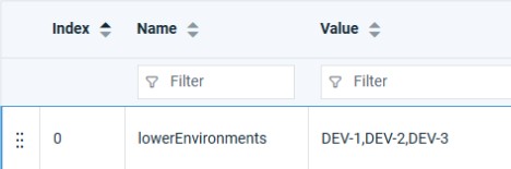

From the hierarchy, it is evident that QA-1 and QA-2 can have versions promoted from the environments in the lower stage which would be DEV-1, DEV-2, DEV-3. For an environment, it’s important  to know which environments are in their immediate lower stage so that the uninstall can be triggered on them. To achieve this, a property named 'lowerEnvironments' is created within the environment to store the names of the lower environments.
Figure-3: The property 'lowerEnvironment' in the QA environment
So, the property defined in QA-1 and QA-2, would have the values DEV-1, DEV-2, DEV-3 in it. Similarly, the property defined in UAT would have the values QA-1 and QA-2 and the value UAT for the PROD environment property.

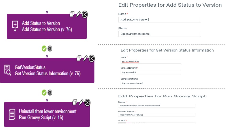

We are going to create version statuses by names of the different environments we have, so we would have statuses like DEV-1, DEV-2 etc. Within the 'component-process' of the 'Install Process' the following steps are added after the application deploy plugin steps,
  • Add the environment name as status to the version.
  • Get the statuses in the version that tells us the environments on which the version is installed.
  • A Groovy step to uninstall on environments common to both "lowerEnvironments" property and the "versionStatuses" from the previous step. Link to the groovy script is  UninstallFromLowerEnvForPromoteInZos.groovy
Figure-4: The new steps in the install component-process
So far, we have devised a way to add the higher environment name to the version status, identify the lower environment on which the uninstall process has to run and also trigger the uninstall process on applicable lower environments.  This process effectively deploys artifacts to the higher environment and removes them from the lower one.

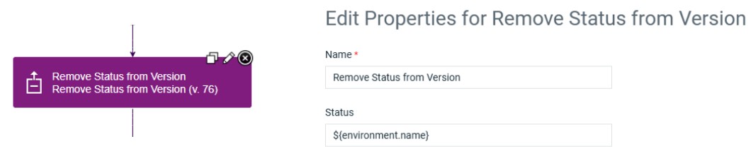

There’s one last step that still needs to be covered. During the uninstall process that is triggered in the lower environment, it is necessary to remove the ‘environment-name’ from the version statuses as it is getting uninstalled from the environment. To accomplish this, we add the below step as the last step in the uninstall component-process.
Figure-5: Add 'Remove version status' step in the uninstall component-process
