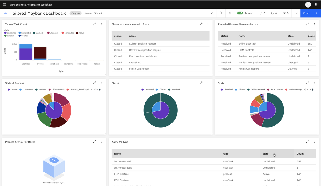

  • End-to-end visibility across processes
    BAI captures real-time event data from Business Automation Workflow processes and transforms it into clear, actionable dashboards. Leaders and operations teams can instantly see how business operations are performing end-to-end — no manual data gathering, no guesswork. A sample dashboard is shown below:

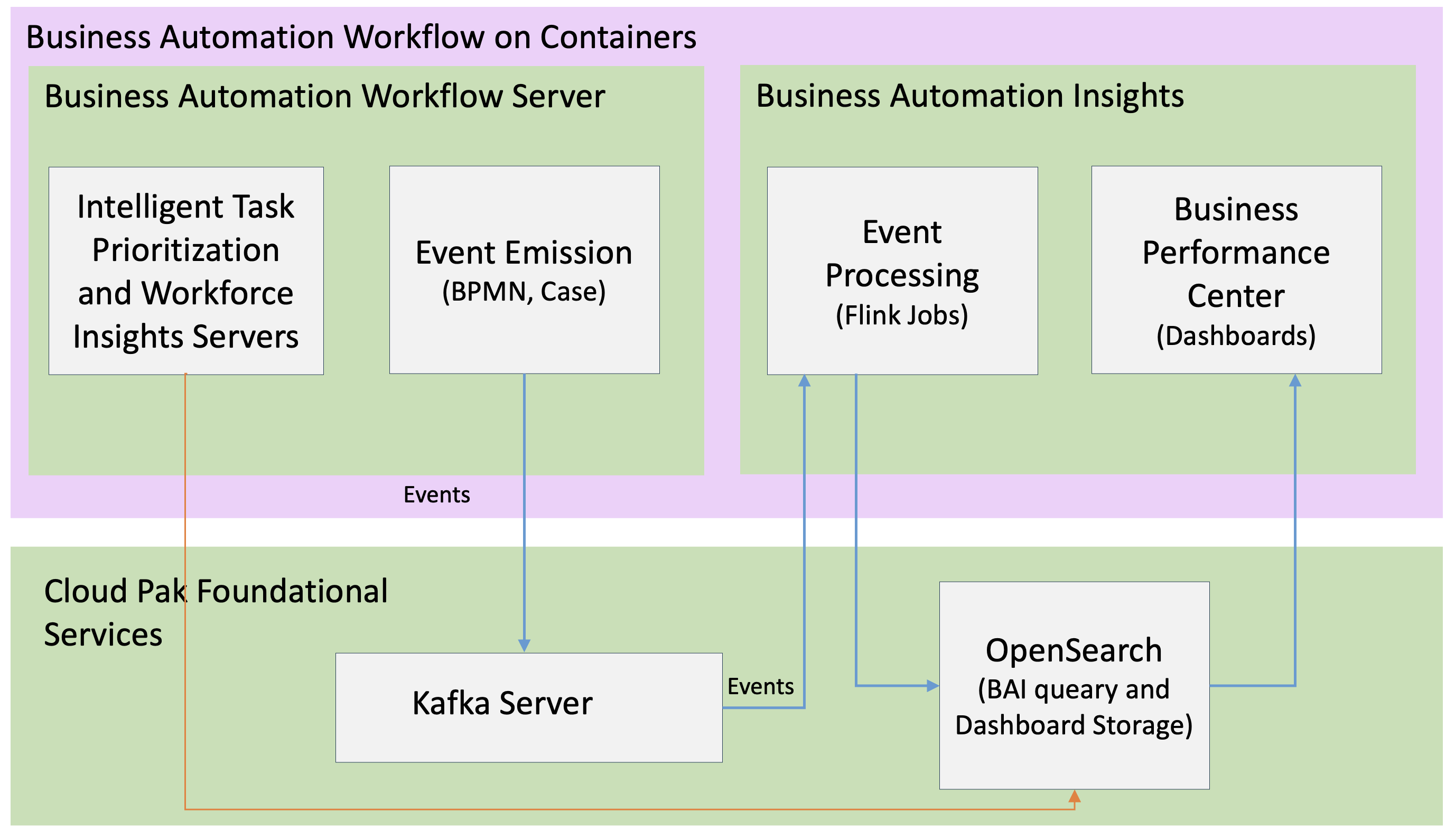

High-level architecture
When Business Automation Insights is enabled within a Business Automation Workflow deployment on containers, the platform starts capturing operational events from the workflow run time. Once enabled, the workflow server sends these events to the Kafka instance included in the IBM Cloud Pak for Foundational Services layer. Business Automation Insights uses Flink jobs to consume and transform these events, and store the processed output into OpenSearch indices, creating structured, query-ready data for analytics. Business Performance Center then reads directly from the OpenSearch indices to deliver real-time insights into BPMN flows, case activities, and content interactions. This architecture ensures a continuous flow from event emission to visualization, giving teams immediate visibility into process performance and bottlenecks.
The diagram illustrates how Business Automation Insights integrates with Business Automation Workflow on containers.
