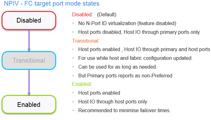

Three transition states or “fctargetportmode” states are provided for the seamless enablement of NPIV feature in existing as well as new SVC configurations.
