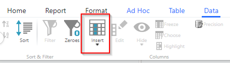

    I don't think there's a way to change the color of a field that is brought in directly from the backing dataset, but you should be able to do this with by inserting a new field that references the field from the backing dataset.
    You'll need to create a new column in the report using the Insert option in the Ribbon.

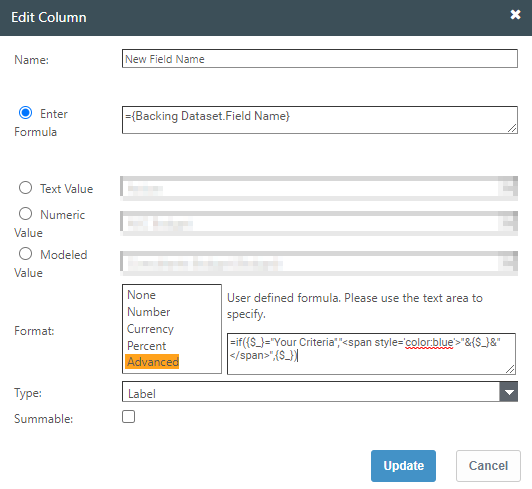

    From there, you'll want to define the field format as Advanced and then just define the format as follows:
    This example will change the color of the text to blur if the criteria is met, otherwise it will leave it as black.  You can nest Ifs here to define a number of different colors if needed.  And you can also reference other fields for your criteria... for example, =if({Backing Dataset.Criteria Field}="Your Criteria","<span style='color:blue'>"&{$_}&"</span>",{$_}).  If you do need to reference another field, you'll just need to make sure that other field is dropped into the Ad Hoc Query window so it's available to the report (and you can hide it if you don't want to show it on the report).
    Edit: Sorry, my screenshot for the Advanced formula makes it look like there is a pipe on the end of the formula.  There should not be a pipe... that's just my cursor! :D
