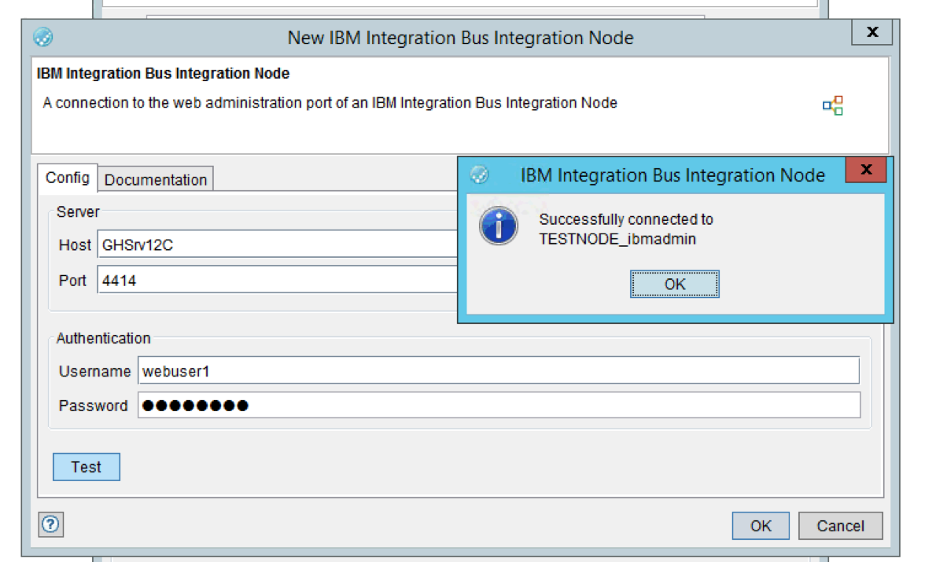

Then create a new Integration Node:
Then configure the Integration Node and test it:
Then click Next and Integration Tester will create the nodes and give you the operations to create Tests and Stubs for Integration Tester:
