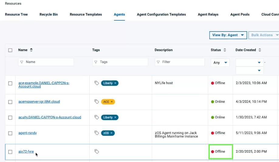

13.  You should see that the Agent is offline in the web console as shown below:
   NOTE: you may need to refresh the page in the browser.
