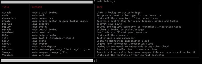

2. Configure the deploy key and log in to webMethods.io Integration.
wmio login
You will be prompted to enter the tenant URL, email associated with your tenant and the tenant developer key.
To retrieve the developer key, login to webMethods.io Integration and navigate to the Profile icon > Settings.
Once you have entered these details, you will be logged in to the webMethods.io Integration.
Your Connector Builder package will be installed and ready to go at this point.
3. Create a directory for your app with the minimum required files
wmio init
You will be prompted to provide a name and description for your app, which will be displayed in the Services tab.
Once you have entered these details, it will automatically download the required files for your app and will create an app directory inside the Connector Builder folder.

To get the list of all the webMethods.io Integration-CLI commands along with their details, run the following in the command prompt:
wmio help
or
wmio
Given below is the list of all Connector Builder commands:
1. wmio login
Configures the deploy key and logs you into webMethods.io Integration
2. wmio logout
Logs you out from webMethods.io Integration by deleting your access token from the home directory
3. wmio connectors
Displays the list of all apps for the current user
4. wmio init
Initializes a new webMethods.io Integration app in your directory Example: wmio init sample_app
5. wmio create
Creates a scaffolding for trigger, action and lookup in app directory Example: wmio create trigger new_mail
6. wmio auth
Creates an authentication scaffolding in the app directory
7. wmio attach lookup
Attaches lookup to action or trigger field interactively
8. wmio detach lookup
Detaches lookup from action or trigger field interactively
9. wmio deploy
Builds an app and deploys it to webMethods.io Integration
Connector Builder will update the existing version of your app unless you change or increase the version before re- deploying it
10. wmio download
Downloads the ZIP file for your app to your current directory
11. wmio versions
Displays the list of all the versions for the current app
12. wmio history
Displays the complete history of the current app
13. wmio swagger  Converts a Swagger to an action
14. wmio help or wmio
Displays the list of all Connector Builder commands along with their details
15. wmio postman
Creates an action file under the action folder of your app directory for each API call
