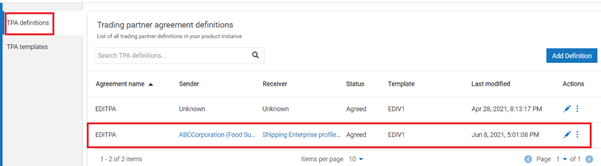

Create Definitions
  • Navigate to agreement tab.
  • Click on TPA definition.
  • Click on Add definition.
  • Select the agreement name, in our case it will be EDITPA.
  • Provide the sender name, in our case it will be ABC Corporation.
  • Provide the receiver name, in our case it will shipping Enterprise.
  • Select the template structure from drop down menu, in our case it will be EDIV1.
  • We also provide the option to download the TPA.
  • Downloaded file will be in json format.
  • Provide the details as per business requirement.
  • Upload the updated TPA agreement.
  • Change the status from proposed to agreed

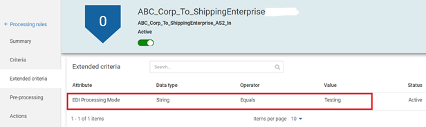

Modify processing rule in B2B
  • In our case, we are sending the inbound transaction to B2B using the HTTP protocol.
  • We will be adding extended criteria conditions to check the particular field value in the payload.
  • While creating the definition we have added condition on processing mode.
  • If the processing mode is testing, then only EDITPA will get invoked.
  • Open the processing rule.
  • Go to the extended criteria section
  • Set the below condition.
