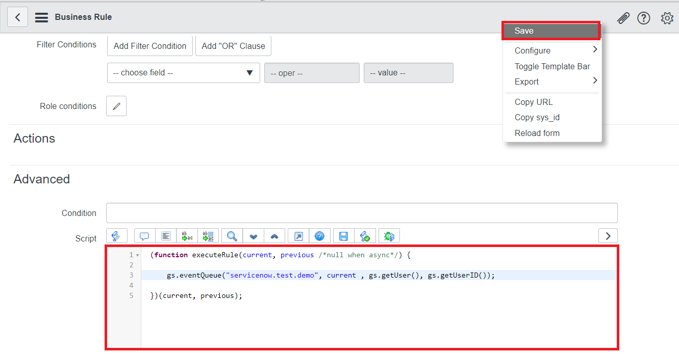

    6. Now we will write a business rule, to trigger the event. Once the event will get triggered it will trigger the Notification as well. So, go to the search bar & search for the “Business rule” & click on the “new” button to create the new business rule. Now provide the “Name” for the business rule. Choose the “Table” as “Incident[incident]” from the drop-down. Checkmark on the “Active” & “Advanced”. Now in the “when to run” tab checkmark on the “insert” based on the user requirement.
       Now on the same page under the “Advanced” tab, we need to write the “SCRIPT”.  Now click on the Save button.

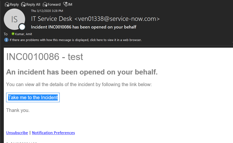

    7. Now again we will create the new event from webMethods.io connector & we will observe the Email logs. Please repeat the Steps:- 10,11,12,13 & 14 mentioned in the link: https://tech.forums.softwareag.com/t/servicenow-email-notification/237436. (Basically, create the new event.). So, as we see in the below screenshot, new Notification I getting triggered from the event.
       Also, it sends the below mail notification as well.
