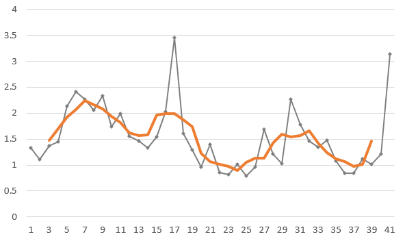

One of the first steps in the decomposition process is to smooth the time series. This helps to remove the random component from the signal and isolate the trend and cycle components. To perform this smoothing a technique called Centered Moving Average (CMA) is used. Here is an example of performing CMA on a time series:
As you can see from the graph, the orange line is a smoothed representation of the original signal. However, the cost of performing this smoothing technique is that there will be data loss at the beginning and end of the smoothed signal. This is due to the fact that CMA requires a certain number of data points before and after the data point that is being averaged. In the above example, the average for the data point at t=3 was calculated by using the value of the data points at t=1, t=2, t=3, t=4 & t=5. The average could not be calculated for the data points at t=1 or t=2 since there were not enough preceding data points. Therefore, the smoothed times series does not have any values at t=1 or t=2.
This is an important point as this data loss will occur when using the STD2 operator. The STD2 operator uses a Centered Moving Average with a period equal to the length of a season (the length of a season is determined using the seasonLength parameter). As a result, the first half-season of data that is streamed into the operator will not return any results. If the input time series is continuous (in other words, the application will continue to run indefinitely), then all of the data points after the first half-season will generate output.
