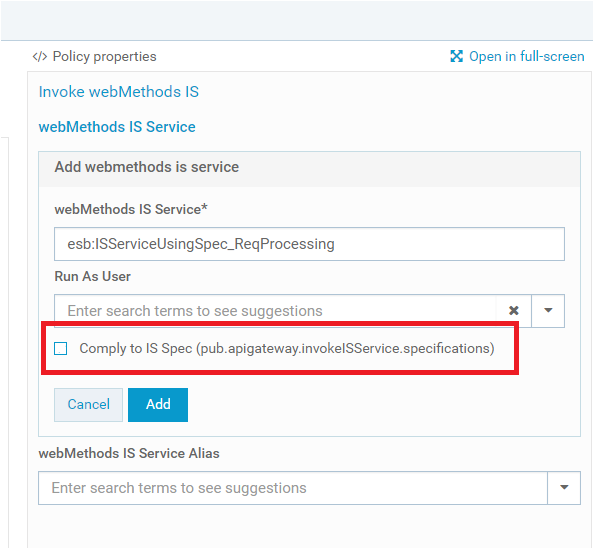

Configuring the webMethods IS Service policy in UI
For request processing, add the Invoke webMethods IS policy in "Request Processing" stage. Similarly for response processing, add it in the "Response Processing" stage.
  • Choose a "webMethods IS Service Alias", if you have created an alias for the webMethods IS configuration. For more details about this, refer the section Using webMethods IS Service Alias
  • Click on "add webMethods IS Service" if you want to add configuration for webMethods IS Service at policy level
The configuration includes:
  • webMethods IS Service - The IS Service that will be invoked
  • Run As User - Invoke the IS Service as a particular user. The value entered here should be an existing IS User. (Note: It is the responsibility of the user who activates the API to review the value configured in ‘Run As User’ field to avoid misuse of this configuration)
  • Comply to IS Spec - Mark this as true, if your input parameters and the output parameters comply to the spec present in pub.apigateway.invokeISService.specifications in WmAPIGateway package
Use pub.apigateway.invokeISService.specifications.RequestSpec for the IS Services invoked at Request Processing stage.
Use pub.apigateway.invokeISService.specifications.ResponseSpec for the IS Services invoked at Response/Fault Processing stage.
To add the above Spec to your IS Service, click on the "Input/Output" tab and click on the "..." on the right end of "Specification Reference" text box. In the popup window that opens navigate to the "pub.apigateway.invokeISService.specifications" folder under wmApiGateway package and select your specification and click "OK"

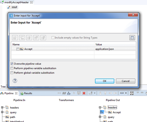

Add/modify a header
  • Drag the "MAP" flow step from palette to the IS Service
  • To add a new header or modify the value of an existing header, right click on the pipeline variable "headers" at the Pipeline Out section and insert String
  • Name it to the header name you want to add/modify (example: 'Accept')
  • Right click on the added string and click on "Set Value"
  • In the new window that opens, set the value of the header and save
  • Now, when the IS Service is invoked during the request/response stage, the value of the headers in the request/response will be modified after the invocation of the IS service

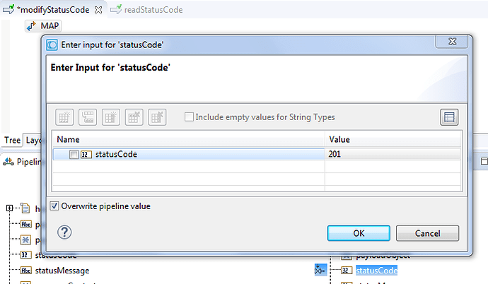

Modify status code
  • To modify the value of status code, right click on the pipeline variable "statusCode" at the "Pipeline Out" section and click on "Set Value"
  • In the new window that opens, set the value of the status code and save
  • Now, when the IS Service is invoked during the response stage, the value of the status code in the response will be modified after the invocation of the IS service
If “Comply to IS Spec” parameter is not marked as selected (false), the transformation continues to work similar to version 10.1, except for few code changes (refer the next section).

  • When you need to do simple transformations that can be configured easily in API Gateway UI, you can use the transformation policy. For example,
    • Add/Modify a header to some constant value (eg: headers.Accept  = application/json)
