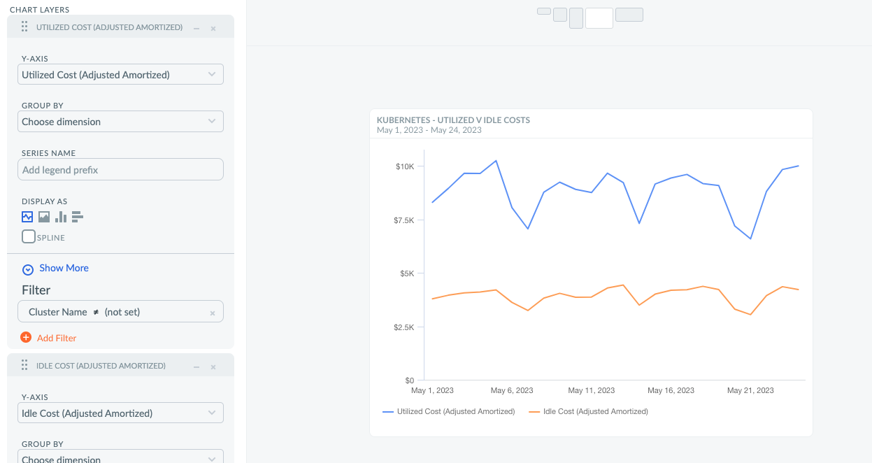

To visualize trends in utilized versus idle costs you can create multiple layers in a dashboard widget. You could do this for all clusters as shown below, or for specific clusters.
