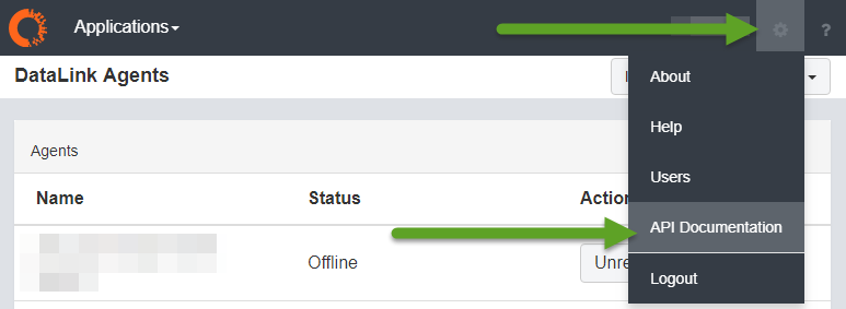

To access Datalink API Documentation, log into datalink manager, click the gear button and select "API Documentation".

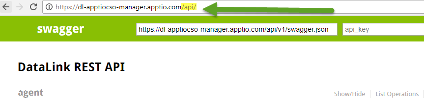

To access Datalink interactive API documentation, log into your datalink manager. Once on the page listing agents edit url to to include /api at the end.

  2. In new browser tab, access the API Helper by adding "/api" at the end of URL.

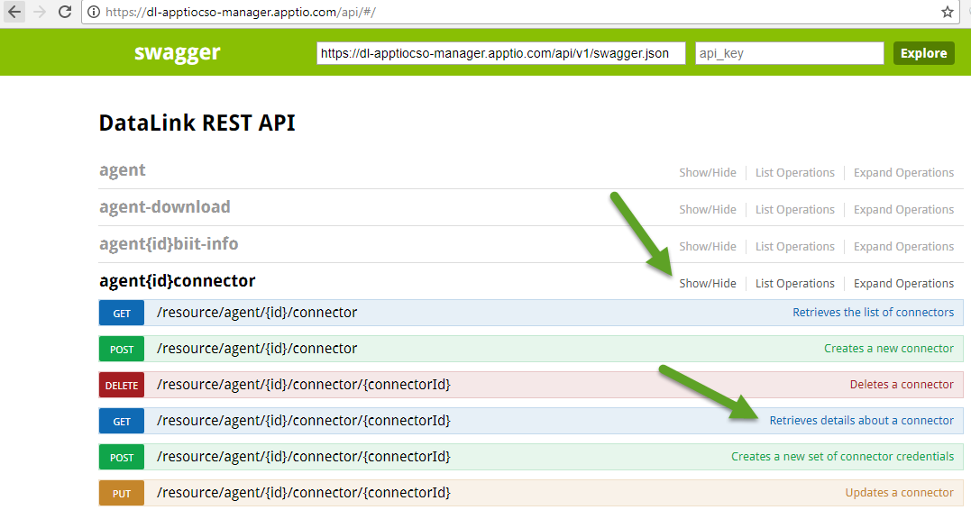

  3. Get the connector's details.

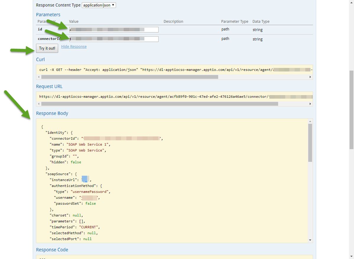

    • Click "agent{id}connector" then "/resource/agent/{id}/connector/{connectorId}".
    • Enter agent id and connector id from step 1 and click "Try it out!".
    • Copy the contents of Response Body and save with .json extension.
      These are all the settings for your connector.

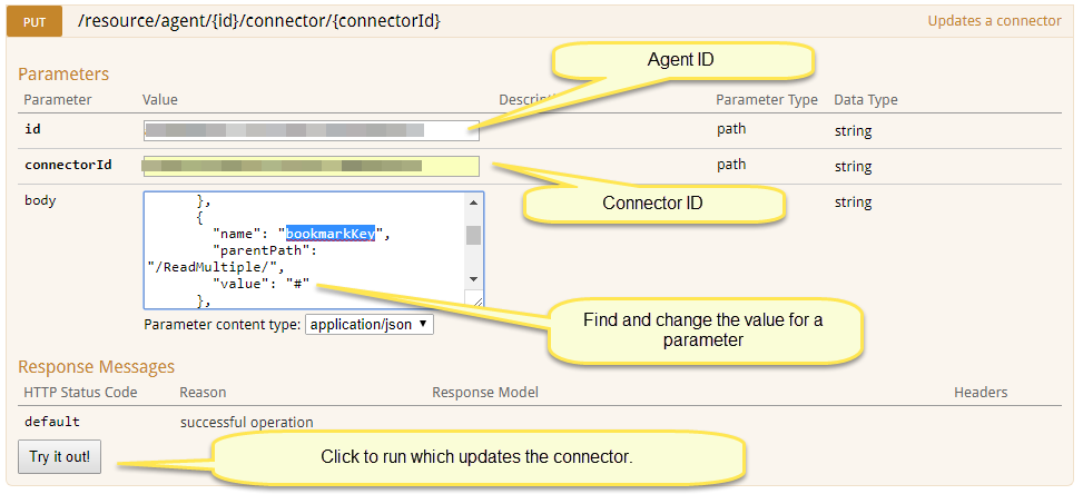

  4. To edit same connector, find "PUT /resource/agent/{id}/connector/{connectorId}"
  5. Enter agent and connector IDs.
  6. Paste the contents of .json file or output from retrieve connector details step.
  7. Modify the values.

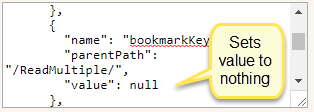

    NOTE Some SOAP endpoint APIs require a parameter to be set but value to be null. To set a value to null, replace current value with quotes like "#" to null without quotes.
  8. This is how to set nothing or null for a parameter:
