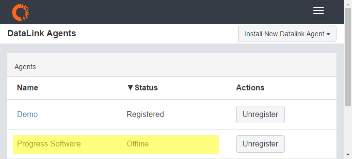

Your Datalink Agent or Datalink Manager is offline.
Datalink Agent Offline
Datalink Engine Offline

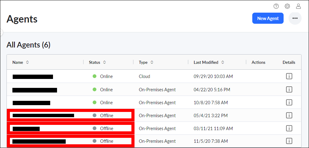

In your Datalink Agents menu, the Agent is listed with the Status of Offline.
The Datalink Agents panel lists all your connected Apptio Agents and their status, including those that are OFFLINE

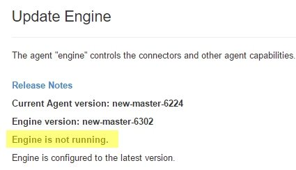

  1. In your Datalink Manager, click the Agent link.
  2. Click the gear icon in the upper-right corner of the screen, then select Settings.
  3. The Update Engine shows a message that the Engine is not running.

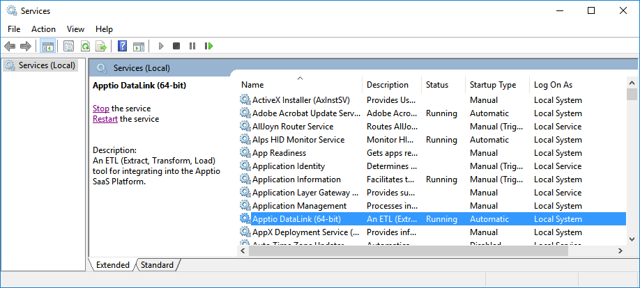

You can restart the Agent using Windows services.
  1. In Windows, open Administrative Tools to find the Services tool.
  2. Select the Apptio DataLink (64-bit) service and click Restart.

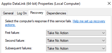

Thu February 07, 2019 04:12 PM
In some cases in Windows OS stopping DataLink service fails. Use this method to end the process.
Open task manager and find one or two datalink processes. Right click on each and select End Task.
Wait a minute and check that process did not restart. If it does set datalink service Recovery options to take no action.
