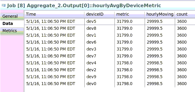

Last thing is how to admire the data and validate it. Typically I use a custom operator for this. Initially I do not add any logic to the operator and simply use the Streams Studio Show Data feature to watch the tuples flowing. Once I have corrected any functional errors I add validation logic. In this case each average is the midpoint of the series (that is why I used a simple incrementing series in the beacon because I can instantly calculate the average for that based only on the last metric(n-1800+0.5). Here is some show data results after I let this run for a while:
