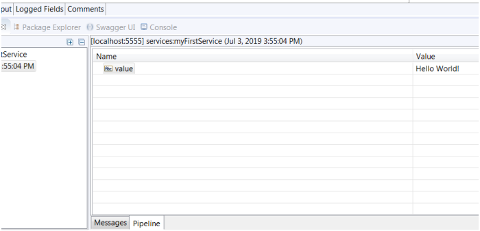

  11. Run the service:
    a. Click Run.
    b. Provide the input when prompted. Example: type “Hello ” for InputA, and type “World!” for InputB.
    c. Click Ok.
  12. The two string inputs that you provide are concatenated and the result (such as, “Hello World!”) is displayed in the Results tab.
