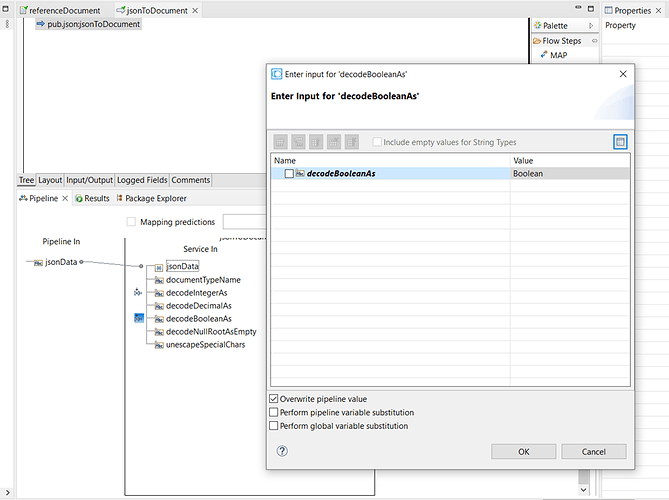

Case 4: Convert the JSON input to an IData by providing the decodeAs fields:
Provide the JSON input as:
"employeeName" : "Sam",
"employeeAge" : 28,
"employeeJoiningDate": "2022-10-10",
"employeeDesignation" : "Software Engineer",
"isReferral" : true
Here the decodeIntegerAs field is set to String and the decodeBooleanAs field is set to Boolean
Now the output contains all the integers in the JSON input as String and all the Boolean values in the input as Boolean.
