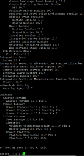

  1. At this stage, it will ask you to select the products that you want to choose in the image. I want to install a core Integration Server, so I select the proper number 250 as shown below in the images. It will prompt you to select the required dependencies, you say Yes to that and select those as well. Press enter once you are done with selecting the dependencies.
Important note: As per documentation present at https://documentation.softwareag.com/webmethods/wmsuites/wmsuite107/SysReqs_Installation_and_Upgrade/compendium/index.html#page/install-upgrade-webhelp%2Fto-console_mode_26.html, “You can use Software AG Installer to create Docker images on Linux systems without a pre-existing installation. As part of the image generation, the product Docker scripts, and entry point scripts are used. The Installer client can install any certified products along with their fixes and build a docker image. Only products that are certified for containerization and their top-level dependencies are shown in the product tree and only a single runtime product can be selected at a time. For example, if you select Microservices Runtime then you won’t be able to select Universal Messaging, because both products provide their runtime and entry point scripts. “
