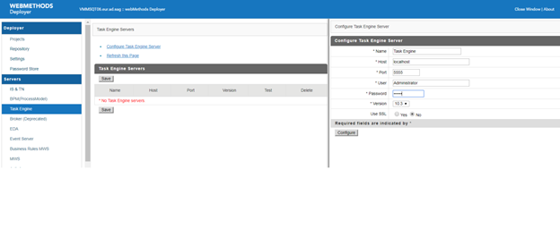

2.    Deployment: Task needs to be deployed to IS using Deployer.
a.    The task designed in the Designer needs to be compiled using Asset Build Environment. In the build.properties file make the following property true: enable.buld.TaskEngine
b.    Using Deployer. In the Deployer configure the Task Engine Server and deploy the asset to IS Task Engine.
Note: In the Runtime task should be monitored from Business Console.
