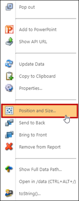

@Henrique Scheffer Pagination refers to the ability of a table in the PDF report to print out all rows in the table across multiple pages. The term, 'pagination', is actually from an earlier release
Here are the steps to configure a table to print all rows across multi-pages:
When the report is printed to PDF, the table will print across multiple pages.
