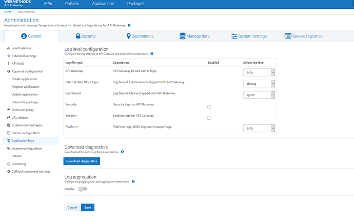

Setting the log levels for different components
The log levels for different components can be configured in the "Administration → General→ Application logs" section as shown below.
Explanation of log settings for the different components are shown below:
Log file type
Description
Available log levels
Source of the log file
Log file type
Description
1 API Gateway
This setting changes the log level of API Gateway server. All the design time activities like creation of API,Application,Alias etc and the run-time activities like API invocation will be logged based on this setting
off, trace, debug, info, warn, error, fatal <APIGatewayInstallationDir>/IntegrationServer/instances/default/logs/server.log
2 Internal Data Store logs
This setting changes the log level of Internal Data Store. All API Gateway assets like API,Application,Alias,Policy etc are stored in this Internal Data Store
off, info, debug, warn, error, fatal <APIGatewayInstallationDir>/InternalDataStore/logs/SAG_EventDataStore.log
3 Dashboard
This setting changes the log level of Dashboard. API Gateway internally uses Kibana to show graphs and visualize transnational data
silent, quiet, verbose <APIGatewayInstallationDir>/profiles/IS_default/apigateway/dashboard/startup.log
4 Security
Enabling this logger will store the security events that occur in API Gateway
enable or disable <APIGatewayInstallationDir>/IntegrationServer/instances/default/logs/WMSECURITY*.log
5 Session
Enabling this logger will store the session details like session id, session state, server id, timestamp etc for every login and logout
happening in API Gateway
enable or disable <APIGatewayInstallationDir>/IntegrationServer/instances/default/logs/WMSESSION*.log
6 Platform
This setting changes the log level of components that are available at the API Gateway platform like rampart,axis2,OSGI etc. Setting this log will require a API Gateway restart
off, trace, debug, info, warn, error, fatal <APIGatewayInstallationDir>/GatewayTrunk/profiles/IS_default/logs/sag-osgi.log
Downloading diagnostics
The download diagnostic button is used to download diagnostics data for API Gateway. The diagnostics data that are collected are as follows.
  • Logs from different components like API Gateway Server, API Gateway UI, Internal Data Store, Security, Session, Platform , Wrapper.
  • Configurations and watt settings that are set in API Gateway
  • A thread dump of all the currently active threads.
All the above data are compressed and sent back. Since the data that is being collected is huge, it takes some time to download the diagnostic data.

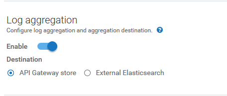

Log aggregation
Enabling log aggregation will collect logs from the different components and store in Elasticsearch. There are 2 options to choose on where to store the logs.
API Gateway store
API Gateway comes with an Internal Data Store which is used to store assets in API Gateway.

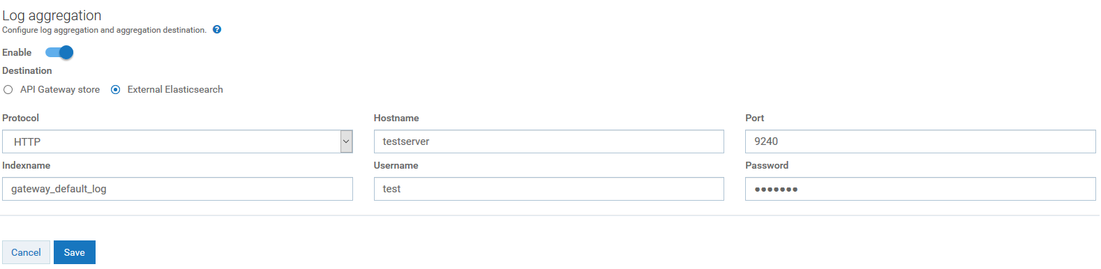

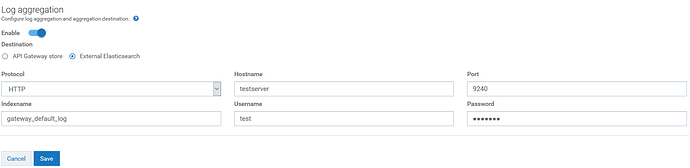

External Elasticsearch
The external Elasticsearch server details such as host name, port, etc should be configured.
The Elasticsearch server configuration details are given below.
S.No
Fields
Description
1 Protocol The type of protocol (HTTP, HTTPS) to use for the host and port combination.
2 Hostname Specifies the host name or IP address of the machine on which external Elasticsearch resides.
3 Port Specifies the port where external Elasticsearch server runs.
4 Indexname Specifies the indexname which will be used by the external Elasticsearch to store the aggregated logs
5 Username Specifies the Elasticsearch user ID for authenticating Elasticsearch when API Gateway communicates with it.
6 Password Specifies the password of the Elasticsearch instance to be used for establishing communication between API Gateway and Elasticsearch.

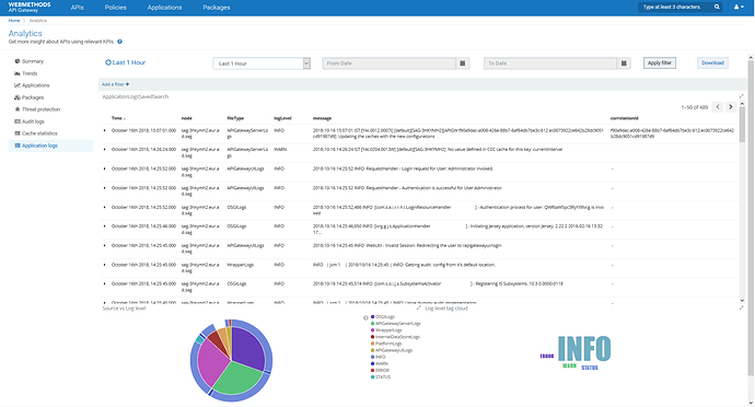

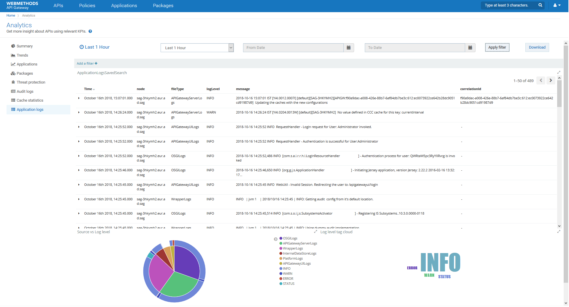

Viewing the logs
Once log aggregation is enabled , API Gateway starts collecting the logs from various sources. These logs can be visualized and downloaded by navigating to "Analytics → Application logs". This analytics page will be rendered only if log aggregation destination is "API Gateway Store".Customer has to have their own tool to visualize the collected logs when "External Elasticsearch" destination is used to store aggregated logs.

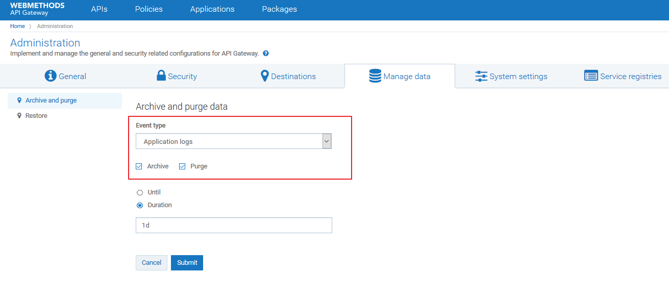

Archiving, Purging and Restoring
Once the log aggregation is enabled , API Gateway starts collecting logs from various sources. These logs can be archived, purged and restored by going to "Administration → Manage data". The archive, purge and restore can be done from this screen only if the log aggregation destination is "API Gateway Store". Customer has to have their own logic for archiving, purging or restoring when "External Elasticsearch" destination is used to store aggregated logs.
