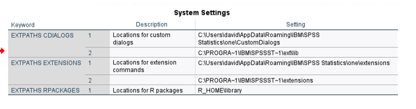

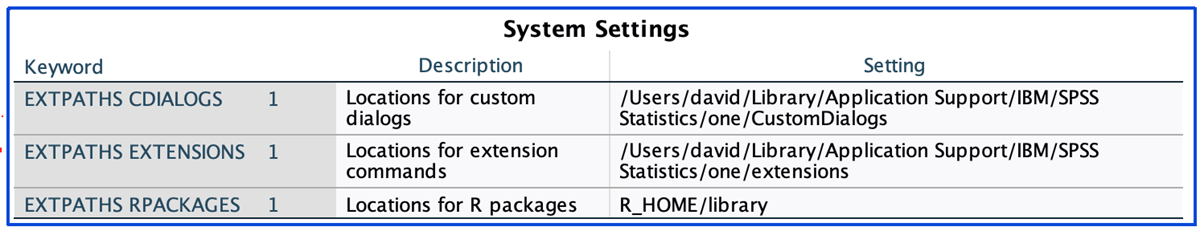

Extension commands resources should install under your User profile.  If you don't have full access to your own profile, that is indeed a problem to discuss with your Administrator.
macOS - SHOW EXTPATHS.
Windows - SHOW EXTPATHS.
