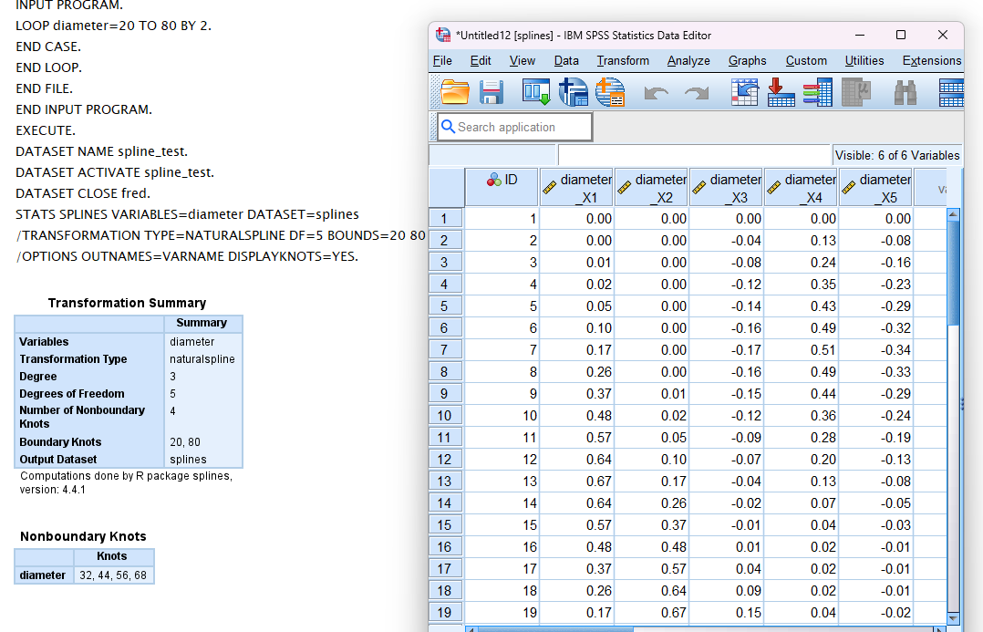

Jon Peck's profile image
Jon Peck IBM Champion
This is what I get with the updated command.  What do you see?

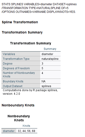

Robert Lundqvist's profile image
Robert Lundqvist
Strange. I get the same error message as before. It runs as intended when there is no BOUNDS option, so the extension works at least partially.
I also tried to uninstall the extension through the Extension Hub followed by a new install, but the result was the same. Could it be the communication with R that causes this?
