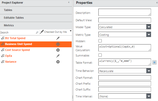

Not sure if this will work, but took a few existing calculated metrics and re-saved as something different to get this:
There was a metric in there called 'BU Total Spend' and I did a 'Save As' and called it 'Business Unit Spend'.
OpEx is already in there and I did a 'Save As' and called it 'Cost Source Spend'...

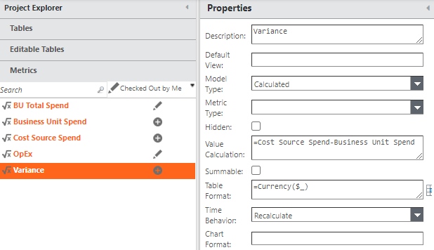

Then created a new calculated metric called 'Variance' where I subtracted the two...
Unsure about the 'BU Total Spend' one - even if OOTB, seems like it's just looking at Cost.  Will dig into it some more tomorrow and get back to you. 😊

So on the Variance KPI how did you get anything to return on that even though I'm getting something for Cost Source and BU Cost in a KPI the variance is returning $0 as this has to be configured to one object

Hey @Claire Finch!  I knew something was fishy about that 'BU Total Spend'.  Change the Value Calculation for the 'Business Unit Spend' metric to this instead: =LookupObjectTotalValue(Business Unit Allocation).  That should do it! ​

@Jenny Franklin - Hi many thanks works like a dream :-)​​​
