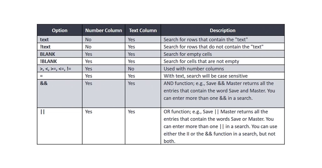

Justin Hazelrigg's profile image
Justin Hazelrigg
I screen grabbed this from a presentation. Useful in these type of scenarios
#TBMStudio
