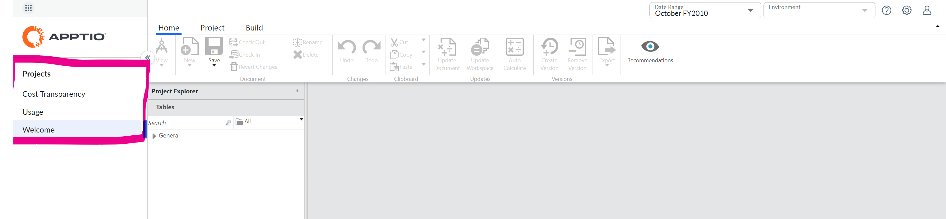

Common to all three questions, the meaning of Projects is not objects or components, but Projects like attached images.
Based on that, we would appreciate it if you could answer again.

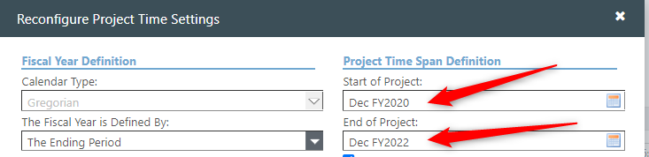

  • In the Time Settings we move forward the project start date (currently DEC2020):
    Before I push the date forward, I extract key data based on a report, so that we keep past history.
  • In the Calculation Settings, we limit the pre-calculated months:
#ApptioforAll

Sorry, @Ryo Yamagami, I read it the wrong way.
I cannot answer that question. I suspect those are Apptio-created projects and thus, we cannot change them. Maybe @Renee Daignault​​ can shed more light.
We can get Support to create further Cost Transparency projects, and maybe they can delete them too.

Apptio Community Member's profile image
@Guillermo Cuadrado
Thank you for your answer.
I'm sorry that there is only Apptio-created projects in the attached image, but I would appreciate it if you could answer three questions about the Projects that we manually created.
