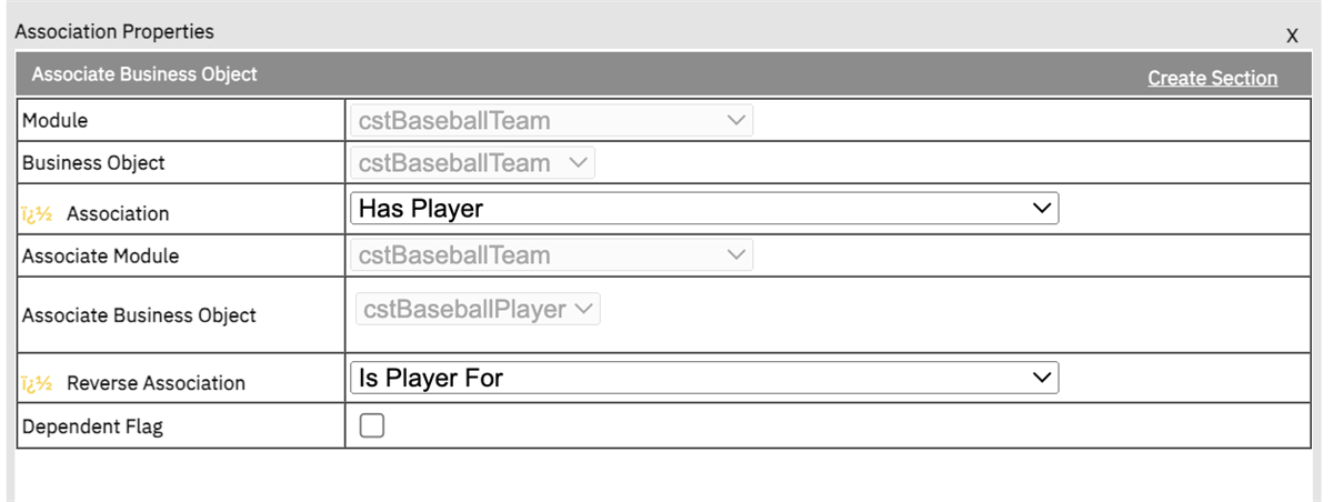

- Association of cstBaseballTeam
Association Settings of cstBaseballTeam

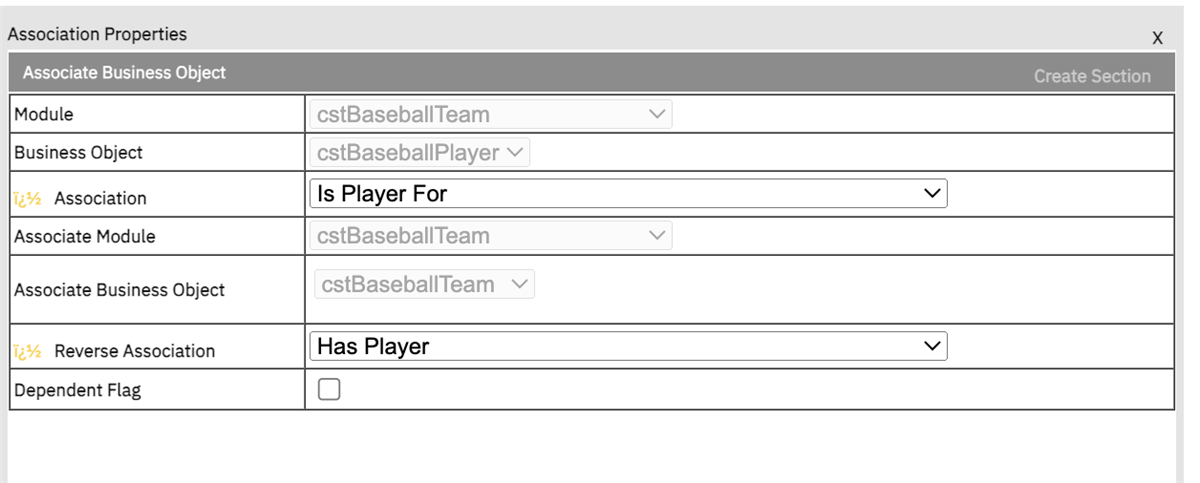

- Association of cstBaseballPlayer
Association Settings of cstBaseballPlayer

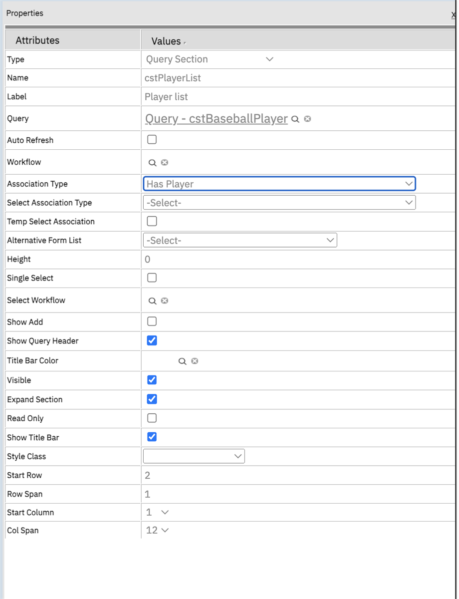

- QuerySection of cstBaseballTeam form
QuerySection settings on cstBaseballTeam form

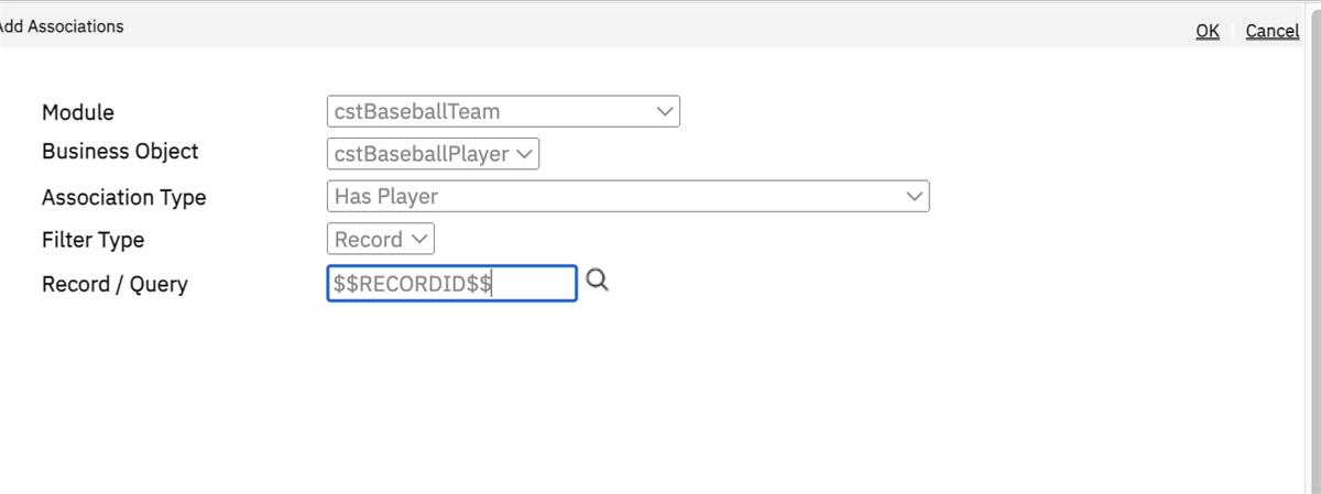

- Association Filter of Advanced tab ("Query - cstBaseballPlayer" that is used in the QuerySection)
Association Filter setting of cstBaseballPlayer query
