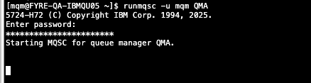

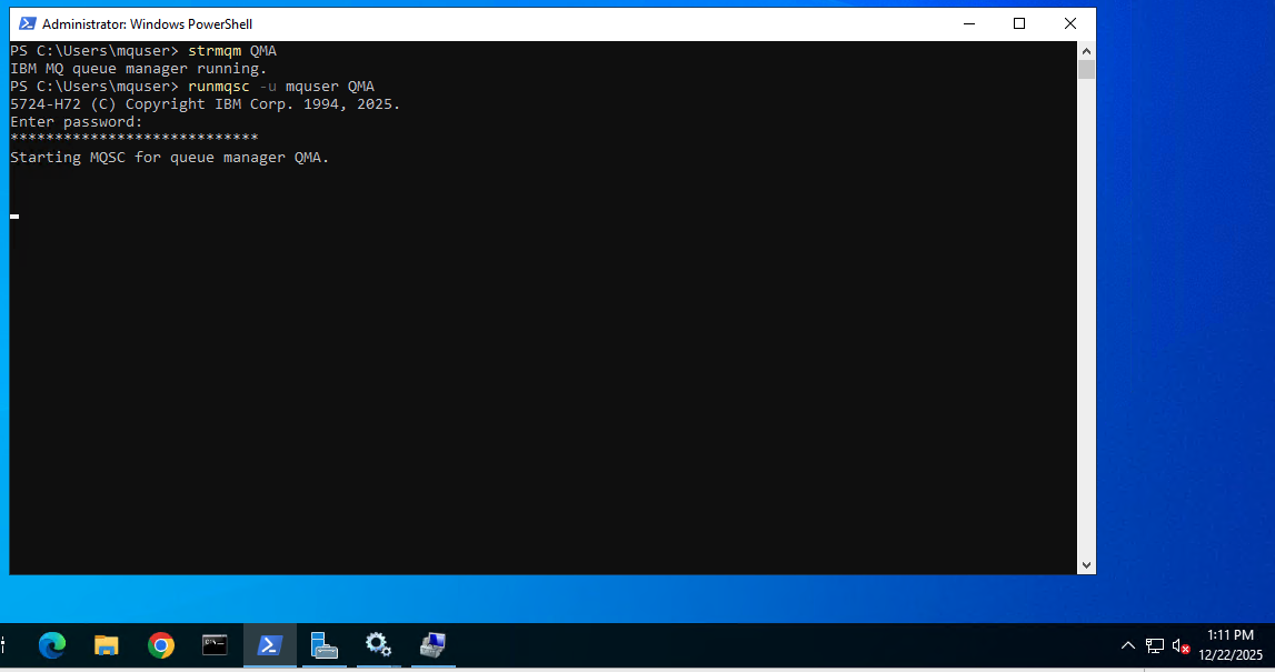

I have a test environment with both Windows and Linux with IBM MQ version V9.4.2.0,
IBM MQ login
IBM MQ Windows Login
The command is correct, following the documentation. In my case, the user is mqm, and the MQ manager is QMA.
