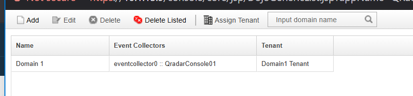

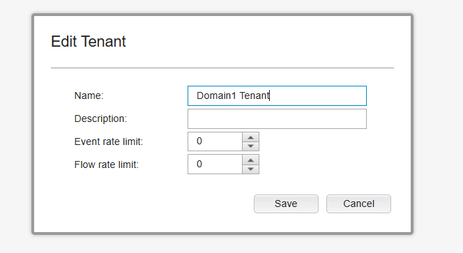

A new tenant had created, I set the eps limit of this tenant is 1 eps and 0 eps to tested that feature. Then I assign it to the domain which have a EC of AIO. But the eps is not limit according to the EPS I set, it doesn't even change. Pls help me resolv this issue.

It's quite likely that trying to limit to 1 EPS isn't going to be very effective. When limiting rates we don't count per event, we count the EPS in an interval (~ 1/2 a second) and then apply the throttle or drop. So, it's entirely possible that you're getting a lot of events in 1/2 to one second. Try 100 or 200 instead and query over a shorter interval to see the results.
