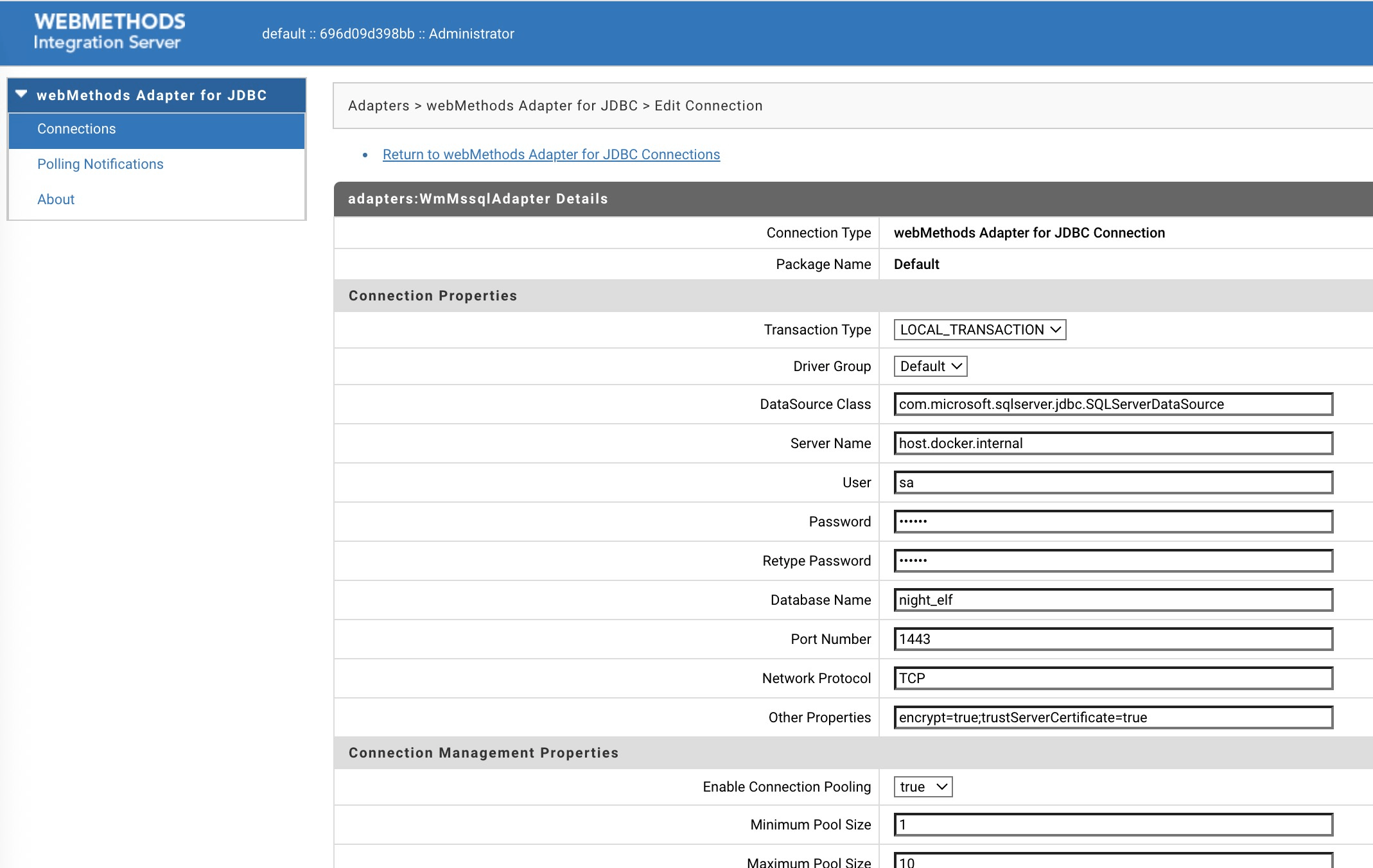

Here is the configuration page for SQL Server 2019/2022, (not work) ❌
![](https://image-1315592840.cos.ap-shanghai.myqcloud.com/obsidian/20250527090809.png)
