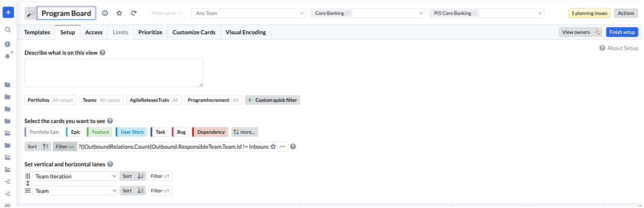

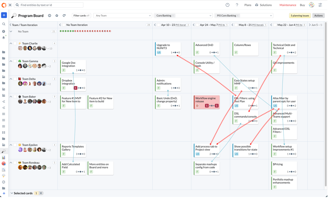

This happens automatically when items are planning into sprints (or program increments) with related items that are also shown on the view not being planned in order.  These will be identified as planning issues and the relation arrow will be red and dashed.  A good example of where these show is the program board.
A sample configuration:

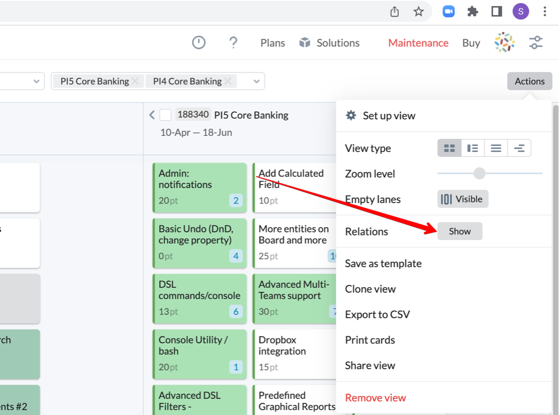

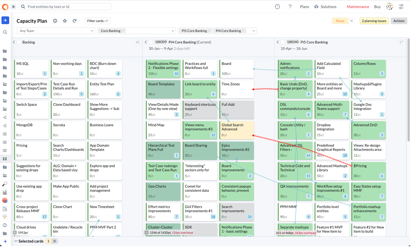

If you look across Program Increments (Releases) this will also happen.  An example would be the Capacity Plan view (just need to show relations on the view!)
Which then looks like this:

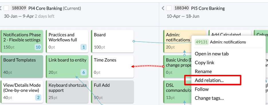

And you may already know, but I like to right click on cards to build the relation while on a view.  Right Click on the card, select Add Relation, then Click which card the arrow should point to.
