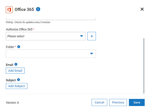

This article explains how to use filters provided for Office365 triggers.
In Office 365 triggers you can use the Email and Subject filter to add a condition based on a particular email address or a particular subject term respectively.
You can click on the “Add Email” and “Add Subject” buttons to add filters.
Let’s see how to add filters for Email ids.
Once you click on Add Email button, you will see a field to add email ID.
Once you add the email ID inside the above Email ID field means, you are configuring the trigger to be executed when the email contains the mentioned Email ID.
