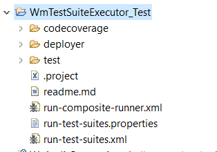

The project contains default Ant build targets and properties to drive the tests. Below is a sample test executor project and its project structure,

  1. To initiate the tests, use the ant build file, run-composite-runner.xml and ant target, composite-runner-all-tests
  2. Modify the properties file, run-test-suites.properties to specify project locations and setting up target Integration Server definition
  3. Specify appropriate values for each property in the run-test-suites.properties file to generate the results in the provided location as HTML files.
Note : Use readme.md for the details of each field defined in property file. To run the headless testing set webMethods.test.setup.profile.mode =NONE

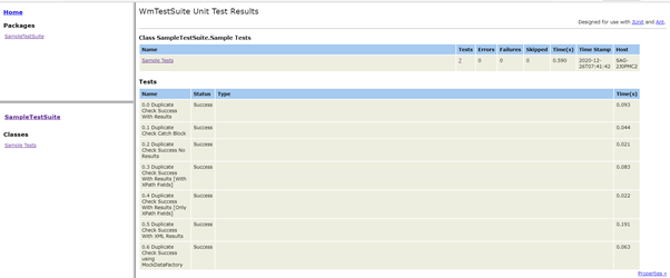

Viewing the results
From the designer, In the project folder, right-click on the ‘ **index.html** ’ and open with any often provided options.
Note: You can also use Nodejs, tomcat, etc. to view the report locally. In Realtime scenario, this execution would be done by Jenkins and Jenkins HTML publisher plugin to view the report from Jenkins Server.

  1. Click Run, After the execution completes the reports will be generated in the respective folders based on the chosen profile mode,
project/test/reports/html > If executed with no coverage mode (webMethods.test.setup.profile.mode =NONE)
project/test/reports/wmcodecoverage > If executed in coverage mode (webMethods.test.setup.profile.mode =COVERAGE)
