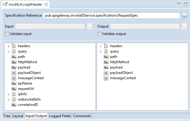

  • Comply to IS Spec - Mark this as true, if your input parameters and the output parameters comply to the spec present in pub.apigateway.invokeISService.specifications in WmAPIGateway package
Use pub.apigateway.invokeISService.specifications.RequestSpec for the IS Services invoked at Request Processing stage.
Use pub.apigateway.invokeISService.specifications.ResponseSpec for the IS Services invoked at Response/Fault Processing stage.
To add the above Spec to your IS Service, click on the "Input/Output" tab and click on the "..." on the right end of "Specification Reference" text box. In the popup window that opens navigate to the "pub.apigateway.invokeISService.specifications" folder under wmApiGateway package and select your specification and click "OK"

  1. Add the spec “pub.apigateway.invokeISService.specifications.RequestSpec” in the specifications of the IS Service.
  2. Add the “pub.flow:debugLog” service to your IS Service.
  3. To access the value of a particular authorization element (say clientId), in the pipeline view, expand the “Authorization” pipeline variable and click on the clientId child variable and drag to “message” which is the input pipeline variable of “pub.flow:debugLog” service (Service In).
  4. Now, when the IS Service is invoked during the request stage, the value of the authorization element you chose will be printed in the IS Server log.
