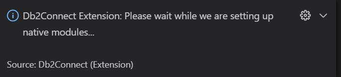

  • If clidriver is already present in your system, please set IBM_DB_HOME = /path/to/clidriver to avoid the download of clidriver.
How to install this VS Code extension:-
  • Click on the Extension icon in the activity bar.
  • Type Db2 Connect and click on the install button.
  • Once the extension is installed you will see the IBM BEE icon in the activity bar.
  • If you face any issues while installing, please check whether your system can access the Github page or not. If not please give permission to access the Github page.
  • In case if you still have issues, please have a look at the log as mentioned below.

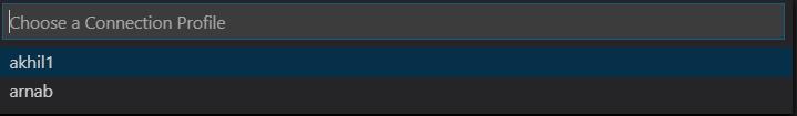

  • If the user chooses the third option, a list of profiles created already will be displayed. (To see profiles users should create a profile which is shown in the next step).
  • Users can choose any profile and make a connection.

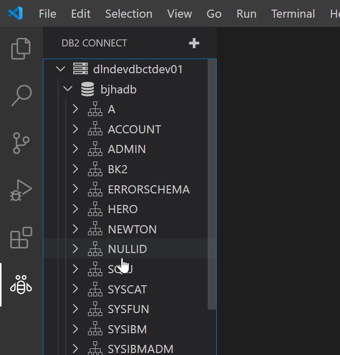

    Tree View: -
    • After the successful connection, a tree view is created in the Db2 Connect view.
    • Database: -
      • Expand the database to see the list of schemas.
      • Right-click on the database to create a new schema, table, alias, view, function, stored procedure, trigger and indexes.
      • Alternatively, click on Add(+)s button to create a schema.

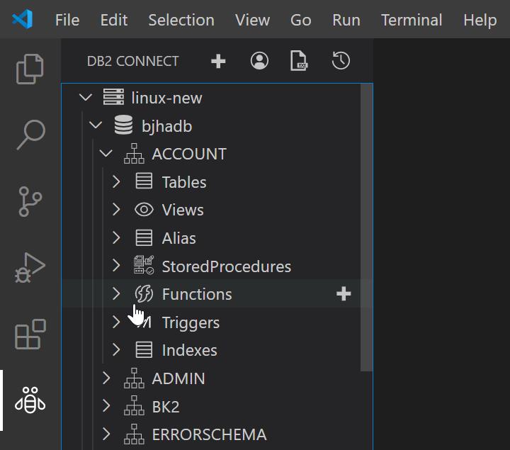

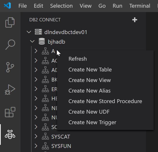

    • Schema: -
      • Expand schema list tables, views, alias, stored procedures, functions, triggers and indexes.
        • Right-click on the schema to refresh schema and create a new table, view, alias, stored procedure, function, trigger and index in that schema.

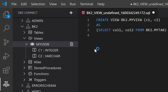

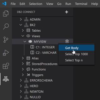

      • Views: -
        • Delete view using a trash icon.
        • Expand view to get the column names with the datatype.
        • Get Body of a view in a file if you want to modify you can modify the view and submit it using execute single sql option (Right-click on the file).
        • Select data from the view.
        • Get Body will open a new sql file with a view body.

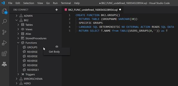

      • Functions: -
        • Expand the functions folder to list the functions.
        • Delete the function using the trash icon.
        • Get Body to get the body of a function stored at the server in a file if you want to modify you can modify the function and submit it using the execute single sql option (Right-click on the file).

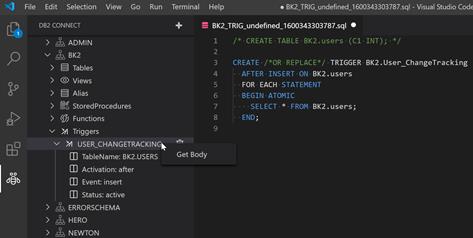

      • Triggers: -
        • Get column names for the trigger.
        • Delete the trigger using the trash icon.
        • Get Body to get the body of a trigger in a file if you want to modify you can modify the trigger and submit it using the execute single sql option (Right-click on the file).
