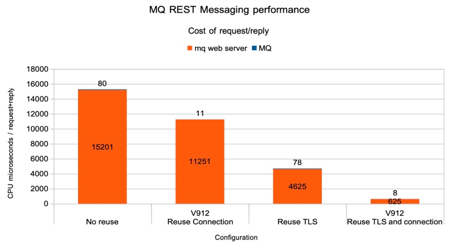

The following chart shows the impact to the cost on z/OS of the 4 configurations.
REST Messaging on z/OS – Transaction cost with 10 clients making request of 10
bytes and receiving reply of 1KB payload
The costs shown are in CPU microseconds, i.e. the “no reuse” configuration cost 15.2 CPU milliseconds per request in the mqweb server and 80 CPU microseconds in the MQ queue manager address space.
Being able to re-use the TLS connection made the largest difference – in our measurements this equated to approximately 11 CPU milliseconds.
The ability to re-use the connection to the queue manager however also results in a significant cost reduction, in our measurements this was of the order of 4 CPU milliseconds per request/reply in the mqweb server address space.
In addition, there is a small reduction in the costs in the MQ queue manager due to a number of reasons:
  • Re-using the connection – the MQCONN is a relatively expensive API.
  • As we were running with class(3) accounting enabled, each new connection would create a new SMF type 116 record. This meant that for a workload of 10,000 requests, reusing the MQ connection reduced the number of SMF 116 records from 10,000 to less than 20.

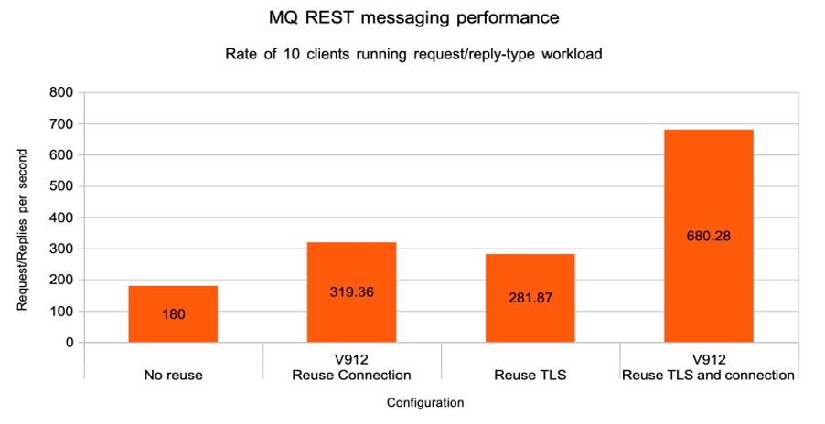

Re-use, both of the TLS connection and the MQ queue manager connection, makes a difference to the achievable transaction rate too, as indicated in the following chart:
REST Messaging on z/OS – Transaction rate achieved with 10 clients making request of 10 bytes and receiving reply of 1KB payload
Being able to re-use both the TLS connection and the MQ connection saw a 3.75 times improvement in throughput, which coupled with a reduction in cost to just 4% of the initial configuration, may make a huge difference when deciding whether MQ REST messaging is appropriate for your use!
