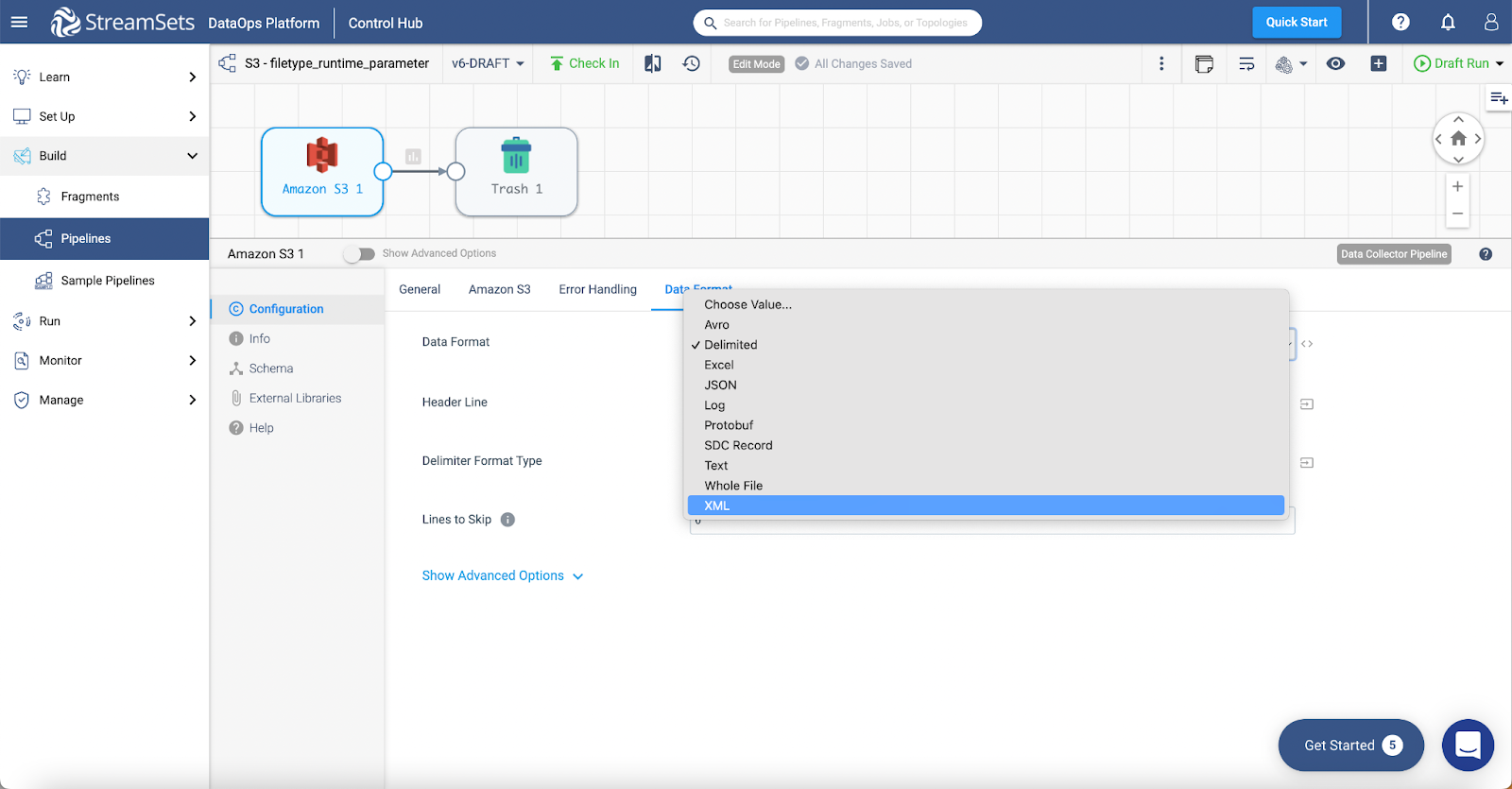

    1. Set the parameters we will use for data format: click on the origin S3 stage > Configuration > data format tab. The main issue when facing this task is that options for each of the data formats disappear as soon we set the parameter for the Data Format value. For example, delimited data format has options like Header Line or Delimiter Format Type. These options do not show anymore as soon as we introduce a parameter for the Data Format value (and therefore they cannot be parameterized). To parameterize these options, we must first set the parameters for each of the data format options (changing between Data Formats in the drop-down list) and then set the parameter for the data format value. Despite the parameterized options disappearing, they keep their parameters assigned and therefore their values can be set up when launched from a job.

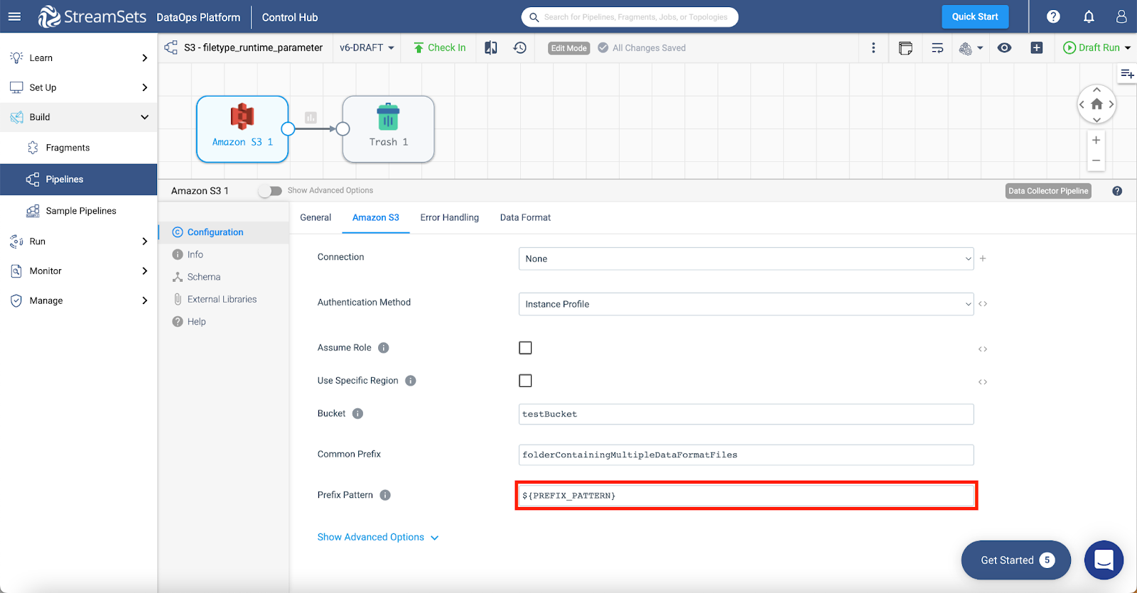

    Finally we have to set the type of file we will be reading. This can be achieved by parameterizing Prefix Pattern under Amazon S3 tab. This parameter can be set to the name of the file extension to filter the files (example: “*.csv”).

    Step 1: Parameterize delimited options:
    qCq6cGhE1NObsxJQfQFndclSwXzzWoELczh04O_6rl1a0YCqd8p4BOSKaMP6T4V-6PzWZkAO-LKZbyUkkiYvCEQmQBk9I2dG5YVA84HZsGVGeXYi4L8_3-3KhsILj5SadkZmCFUkfr4--wZF6Q
    Step 2: Go to XML in the data format drop-down list:
    2xqJ_7hUUx8i0TRc92IkNNgwajU3fxKGx7u5JjQ0mNytbPRhVxvUFbw8MdbQtFl9zJSMUfLdZ8s8-7Qv1uWZc0WmPqDoaCDGCMJ6ASN9nO1FS4Oa0Ee5g1rgZ_eVD04zsACZA0-8XN085GDrqg

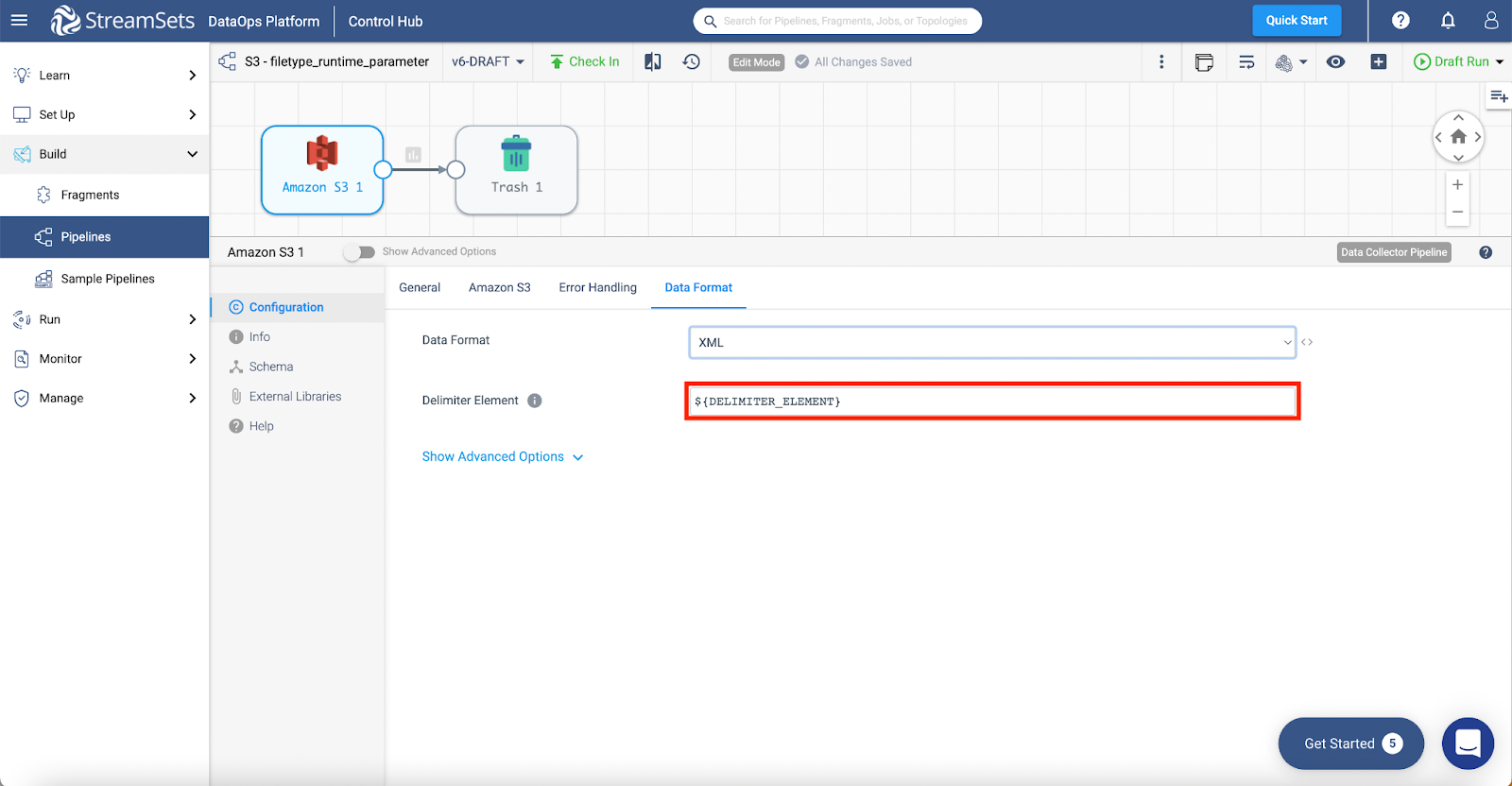

    Step 3: Parameterize XML options:
    m3zUrU60fAZNUBfpDUFGMg2ZvIxNfeizbdWl_QQzp_Ck4GpdrDo_1ozCfK7cSLYDhyVgQtMq9D55nfVhdyy0IgtkCSq-xRESgxQQltBfOzvewxhmyNcLhHRT_9OO_qRNFuLPzIQC196bc_KNjA

    Step 5: Finally create the parameter for Prefix Pattern which will help us filter the income data using the file extension.
    I5D4Plq37l4QKokjqCdY32b2QgbqyhZ-EvlVJo_FhyXQGxSmNEC4v-by-XzDFiXk4iya_i6VQH8ft2ZpLW1MSrxTkZR6uTxj4KNT3Wu7nZ-x7Txnlhz_856QIjkHBgzkUSL8AP-OA7ErtX9aIg
