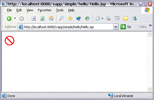

  • 10.  RE: X-Application 4.1.1 build fails
    Posted Wed May 21, 2003 04:04 PM
    Hi Christian,
    The error.jsp file is unlegible (it’s not a plain text file). Is it ok?
    By the way, I followed your instructions and I did not have any return from the page, just a little “forbidden” image (see attached error_jsp.gif). Is that what I should to get?
    Thanx, Ito

  • 11.  RE: X-Application 4.1.1 build fails
    Posted Thu May 22, 2003 09:10 AM
    Hello Fernando,
    What are you meaning with ‘unlegible’?
    If you question relates to the content the error page produces when generating the error message, it is plain text (content-type = text/plain). It is not HTML.
    If you questions relates to the encoding of the file, it should be utf-8.
    That you receive the ‘no access’ sign is strange. When the link does not work directly, please use
    http://localhost:8080/xapp
    However, before invoking the page make sure that Tomcat is running on port 8080. If you have another configuration use the port you specified (the default is 8080). On this page there are links to the examples also for ‘simple’.
    If the links for these pages do not work, there is a mapping problem for context. In this case check the webapps directory of your Tomcat. There should be xml files starting with
    xapp… for each example context. If these files do not exist, the installation was not correct and you have to start the command
    build1 examples
