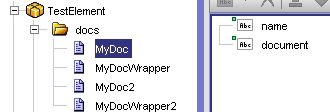

    i have created a very simple document structure containing two document types. One (MyDocWrapper) merely wraps the actual document (MyDoc). See pictures attached Picutres Pic1 and Pic2 as well as attached Package-Zip.

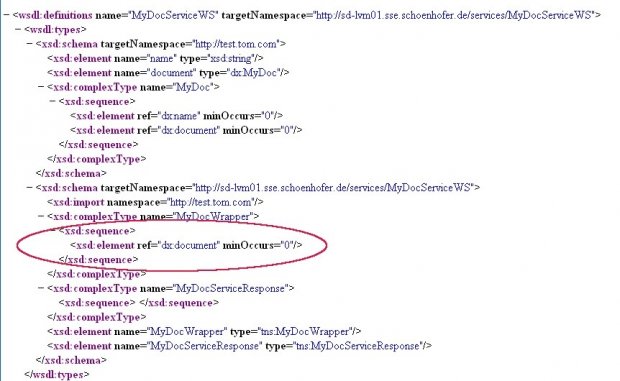

    I’ve given all properties of all documents the same xml namespace. Then i created a FlowService with MyDocWrapper as InputSpec and published it as a Web Service. When trying to test the service using soapui i noticed that the element ‘document’ in MyDoc must not have any value. Looking at the wsdl i found that IS is creating an “element ref” for that property ‘document’ (see picutre Pic3).
    I then changed the name of the property to ‘renamed’ and everything looked as i would have expected it (see picutre Pic4).

    Looks like you have a recursive definition going on in the schema. Was that your intention? Notice how within your complex type you have a document ref. which points back to a global element called document which in turn is typed as MyDoc which has a local element called document which references back to your global element document, recursion.
    When you changed the name of the local element to renamed it, it points to a global element of renamed which is type string.
