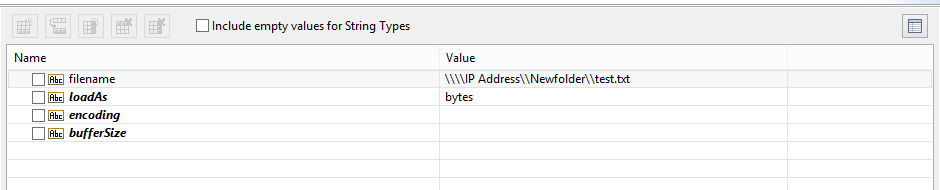

  • 4.  RE: Write file to network drive location
    Posted Tue June 07, 2016 08:57 AM
    Please share what inputs you are passing, also give some screen shots which makes us to understand a bit more clear.

  • 5.  RE: Write file to network drive location
