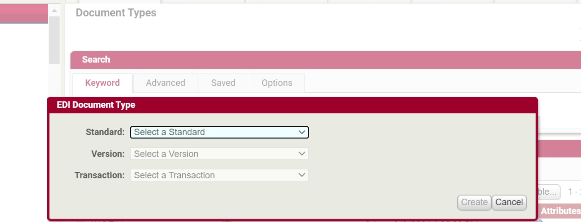

    Hi Mary,
    Thanks for the reply. I attempted to create a new EDI document type, but the options are all disabled as shown in the screenshot (the Standard dropdown is empty). I logged in as Administrator (so I’m assuming this should have all privileges). Do you know if any config or any other settings needs update to be able to create EDI document types?

    Hi Raj,
    I assume this is the first EDI document type you’ve added. It may be an issue with the EDI install. Unless the EDI document type has already been installed in TN, it should appear in the drop down.
    I suppose another possibility is that TN Administrator privilege is required and that is not defined in your Administrator login.
