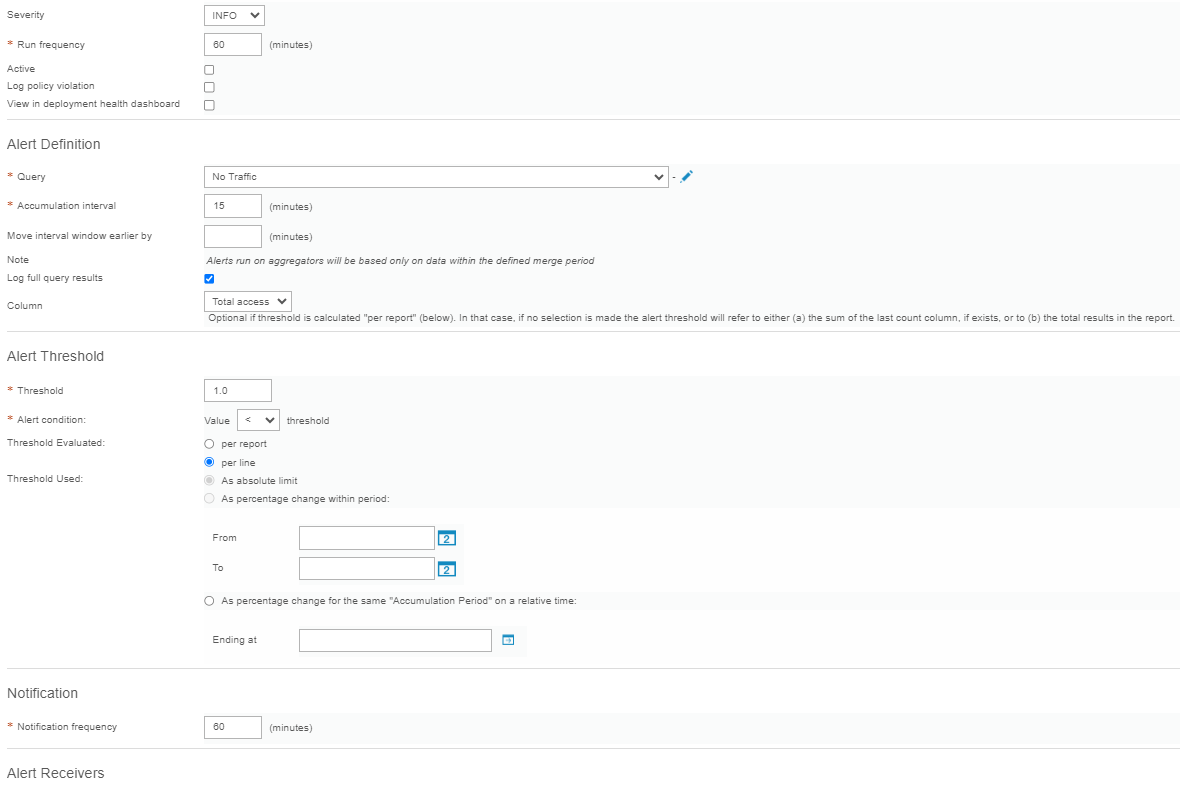

  • 3.  RE: Work No Traffic Alert
    Posted Mon January 22, 2024 09:01 AM
    My configuration
    Yana Nkr

  • 5.  RE: Work No Traffic Alert
    Posted Mon January 22, 2024 09:39 AM
    It was on. Now turned off to change parameters.
    Am I understanding correctly, this will run every hour and check if there is any traffic in the last 15 minutes? If there was no traffic in the last 15 minutes, but there was traffic in the last 48 hours, will the alert be sent every hour until traffic is sent again?
    And if there is traffic in the last 15 minutes, but there was none 20 minutes ago, will this work?
    Yana Nkr
  • 6.  RE: Work No Traffic Alert
    Posted Mon January 22, 2024 09:50 AM
    since you have the parameter set to 15 minutes - this should mean that no traffic for 15 minutes will generate an alert the next time the check runs which is hourly on your config. So it could generate 3-4 alerts if no traffic for 59-60 minutes.
    Not sure where the 48 hours traffic comes in to play. Based on the configuration it should be no traffic for 15 minutes will create an event the next the alert is checked. It should summarize the alerts for the 60 minute time window, but I haven't set it where the Accumulation interval is lower than the alert Run frequency.
    And if there is traffic in the last 15 minutes, but there was none 20 minutes ago, will this work? Based on my understanding if there is a 15 minute period of no traffic you should get an alert even if there was traffic after that before the alert run frequency triggered it is looking at data in a report not active data at that moment in time.

  • 8.  RE: Work No Traffic Alert
    Posted Mon January 22, 2024 12:07 PM
    I got further clarification and it all lines up.
    Run Frequency - 60 minutes - how often it looks at the report data for no traffic
    accumulation interval - 15 minutes - amount of continuous time without traffic (inside the 48 hour period) example 1:00am to 1:16am no traffic valid alert condition
    notification period - how often the alert will be sent to the user(s) default once per 24 hour period. So even if the above condition is true it will only send out once per day. Example notification triggered at 9:00am on Tuesday the next possible time for a notification is after 9:00am on Wednesday.
