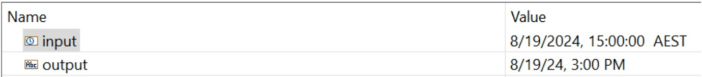

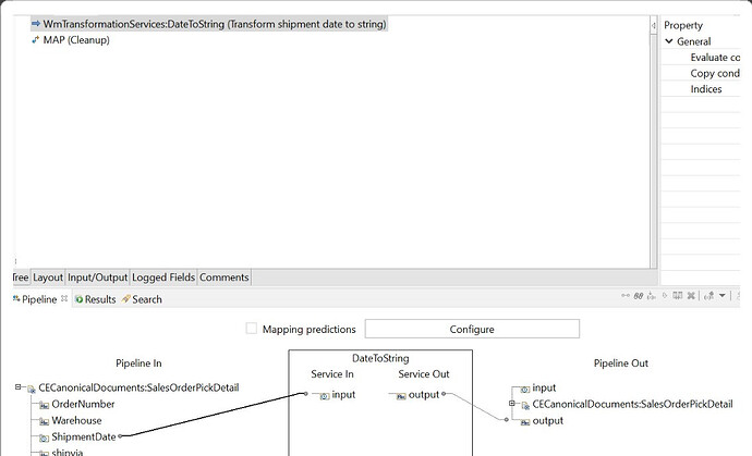

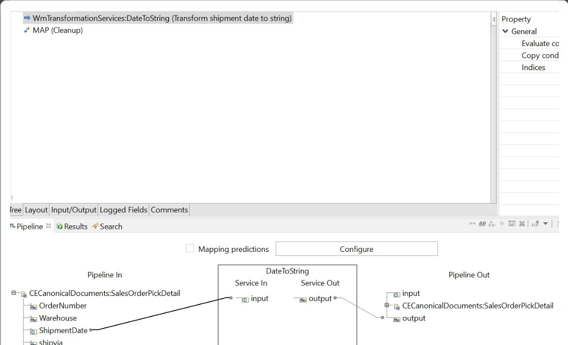

    One of the services ‘WmTransformationServices:DateToString’ belonging to the packages ‘WmTransformationServices’, is adding a comma to the output which causes failure in the further steps.

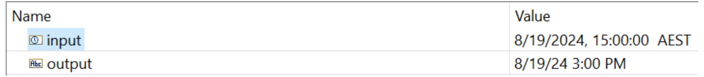

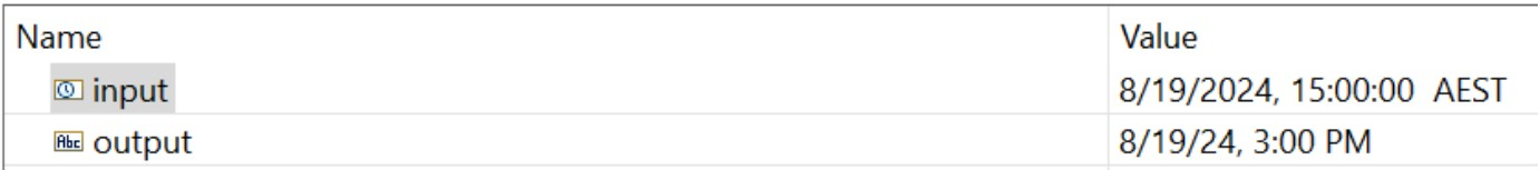

    Pic.1 Attached piece of code produces 2 different outputs in 10.1(desired output - without ,) & 10.15(with ,)
    Pic2 10.1 output
    Pic3 10.15 output

    Looks like you have created a custom package WmTransforamtionServices in your previous version and now it is not working as expected after migrating to 10.15. Better approach is to replace your WmTransformationservices with WmPublic service as it will have proper documentation and well supported by SAG.
    If there is very huge efforts in replacing your existing flow then you need to check and debug “DateToString” service manually and make the requried changes as per your use case.
    Thanks,

    as far as I know, the WmTransformationServices package is a package provided by Professional Services (same PSUtilities) and is not part of the regular installation image.
    You should be able to find the latest version of this pacakge in the download section of this community.
    It was developed for earlier versions of wM but still can be used on current versions.
    In Designer, you can check, where this service is used in your code and replace it with the correspondent WmPublic, which is officially supported. This one has also the benefit, that you can specify the source and target formats.
