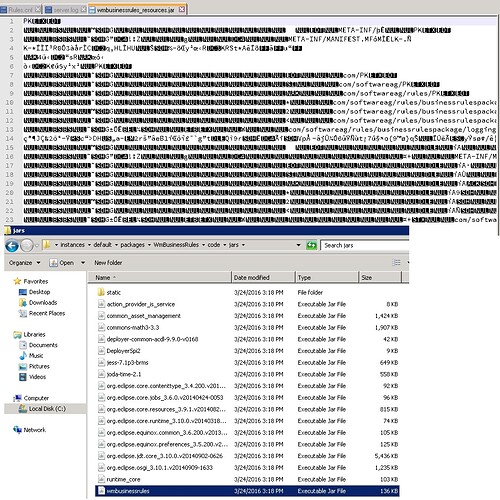

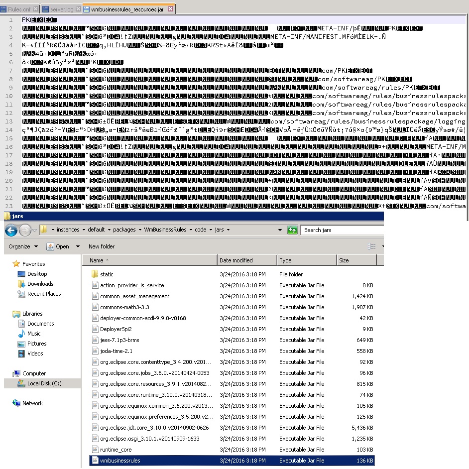

    However, when I try to execute the Decision table from Designer to IS, I get an error as below :
    Unable to execute the requested operation due to an error at package startup. See log for more details!
    Caused by: java.util.MissingResourceException: Can’t find resource for bundle java.util.PropertyResourceBundle, key 0501
    When I manually run the start up service (wm.businessrules.admin:startup), I get the below error.
    com.wm.app.b2b.server.ServiceException: java.util.MissingResourceException: Can’t find resource for bundle java.util.PropertyResourceBundle, key 0501 at com.softwareag.rules.businessrulespackage.StartupManager.startup(StartupManager.java:91) at wm.businessrules.admin.startup(admin.java:221) at sun.reflect.NativeMethodAccessorImpl.invoke0(Native Method) at sun.reflect.NativeMethodAccessorImpl.invoke(NativeMethodAccessorImpl.java:62) at sun.reflect.DelegatingMethodAccessorImpl.invoke(DelegatingMethodAccessorImpl.java:43) at java.lang.reflect.Method.invoke(Method.java:497) at com.wm.app.b2b.server.JavaService.baseInvoke(JavaService.java:407) at com.wm.app.b2b.server.invoke.InvokeManager.process(InvokeManager.java:643) at com.wm.app.b2b.server.util.tspace.ReservationProcessor.process(ReservationProcessor.java:39) at com.wm.app.b2b.server.invoke.StatisticsProcessor.process(StatisticsProcessor.java:49) at com.wm.app.b2b.server.invoke.ServiceCompletionImpl.process(ServiceCompletionImpl.java:243) at com.wm.app.b2b.server.invoke.ValidateProcessor.process(ValidateProcessor.java:49) at com.wm.app.b2b.server.invoke.PipelineProcessor.process(PipelineProcessor.java:171) at com.wm.app.b2b.server.ACLManager.process(ACLManager.java:303) at com.wm.app.b2b.server.invoke.DispatchProcessor.process(DispatchProcessor.java:34) at com.wm.app.b2b.server.AuditLogManager.process(AuditLogManager.java:371) at com.wm.app.b2b.server.invoke.InvokeManager.invoke(InvokeManager.java:547) at com.wm.app.b2b.server.invoke.InvokeManager.invoke(InvokeManager.java:384) at com.wm.app.b2b.server.HTTPInvokeHandler._process(HTTPInvokeHandler.java:254) at com.wm.app.b2b.server.InvokeHandler.process(InvokeHandler.java:101) at com.wm.app.b2b.server.HTTPDispatch.handleRequest(HTTPDispatch.java:178) at com.wm.app.b2b.server.Dispatch.run(Dispatch.java:386) at com.wm.util.pool.PooledThread.run(PooledThread.java:127) at java.lang.Thread.run(Thread.java:745) Caused by: java.util.MissingResourceException: Can’t find resource for bundle java.util.PropertyResourceBundle, key 0501 at java.util.ResourceBundle.getObject(ResourceBundle.java:450) at java.util.ResourceBundle.getString(ResourceBundle.java:407) at com.softwareag.rules.businessrulespackage.logging.Messages.get(Messages.java:15) at com.softwareag.rules.businessrulespackage.targetruntimes.dao.TargetRuntimesDatabaseAccess.throwNewServiceException(TargetRuntimesDatabaseAccess.java:254) at com.softwareag.rules.businessrulespackage.targetruntimes.dao.TargetRuntimesDatabaseAccess.insertOrUpdateTargetRuntime(TargetRuntimesDatabaseAccess.java:81) at com.softwareag.rules.businessrulespackage.targetruntimes.TargetRuntimesManager.registerCurrentRESInstance(TargetRuntimesManager.java:38) at com.softwareag.rules.businessrulespackage.StartupManager.startup(StartupManager.java:85) … 23 more
    What configuration is missing?

  • 10.  RE: wM BR 9.9 Unable to execute
    Posted Fri April 01, 2016 08:23 AM
    This is the only message with the start up service. Same comes when IS starts.
    Unable to figure out which java.util.PropertyResourceBundle, where to configure or set or install it.

    Hi Revathi,
    please check your installation directory for the following file:
    IntegrationServer\packages\WmBusinessRules\code\jars\static\wmbusinessrules_resources.jar
    Does it exist and if yes, is it accessible (readable)?
    Additionally check for the directory IntegrationServer\packages\WmBusinessRules\code\jars.
    How many jars do you have here?
    My 9.5 SP1 version shows 9 jars.
    Please share the server.log snippet for the IS start.
    Can you try to start with an higher loglevel (option “-debugTrace”)?
    If the mentioned file does not exist please try the following:
    Are you able to uninstall and re-install (or overinstall) the Rules Engine Support for IS?
    Looks like an Installation issue.

  • 13.  RE: wM BR 9.9 Unable to execute
    Posted Fri April 01, 2016 12:44 PM
    Yes Hogler, I am following this video → - YouTube
    Ok until debug of BR on Designer.
    Unable to export rule to IS. Get the below error.
    Regarding jars in …\IntegrationServer\instances\default\packages\WmBusinessRules\code\jars I have 17. See attached image, bottom part, for names of jars found.
    Regarding …\IntegrationServer\instances\default\packages\WmBusinessRules\code\jars\static\wmbusinessrules_resources.exe, it exists. When I open, I can see some unusual characters. But values in tag are proper English.
    Image of same I have attached for your review.
    Please have a look.

  • 14.  RE: wM BR 9.9 Unable to execute
    Posted Fri April 01, 2016 02:04 PM
    Hey Hogler,
    There was an issue with the DB Pools.
    I created DB components in a diff schema by selecting ALL tables, the reconfigured DB pools to new schema.
    Now its exporting rules to IS and executing rules on IS!!
    Thanks for your troubleshooting advice :slight_smile:

  • 15.  RE: wM BR 9.9 Unable to execute
    Posted Fri April 01, 2016 02:07 PM
    Hi Revathi,
    please check IntegrationServer/packages/WmBusinessRules/config/ for licenseKey.xml and if it is valid.
    Under IntegrationServer\instances\default\packages\WmBusinessRules\code\jars there is a wmbusinessrules.jar, which contains a message.properties file.
    In this one there is a Key 0050.0501 which has error message as “Database connection not available”.
    As Jars have the same file format then Zip Archives, these can be analyzed by any program that support zip archives.
    The number of jars can differ from wM Version to wM Version.
