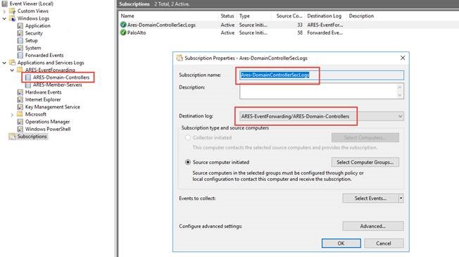

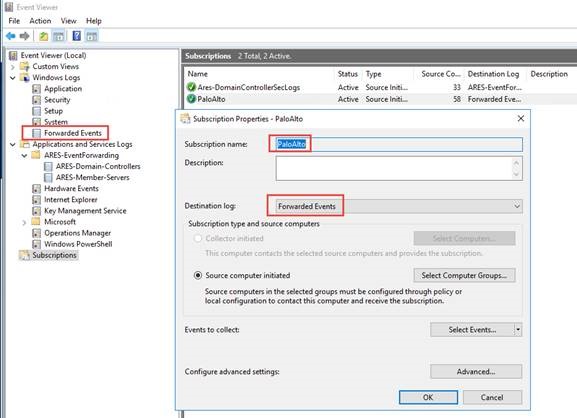

    In the Windows Event Collector LDN-P-EVTCOL01 there are 2 subscriptions.
    • Ares-DomainControllerSecLog
    • PaloAlto
    Windows Event Collector LDN-P-EVTCOL01 there are 2 subscriptions. •	Ares-DomainControllerSecLog •	PaloAlto
    Subscription: Ares-DomainControllerSecLog the Destination Log is "Ares-EventForwarding/ Ares-Domain_Controllers".
    Subscription: PaloAlto the Destination Log is "Forwarded Events".
    In QRadar Log Sources, there is not anywhere I can define "Ares-DomainControllerSecLog" and from the link I provided, XPath Query for forwarded events are not supported.

    We do not support XPath queries for data from the Forwarded log in the Windows Event Viewer. Events that are written using subscriptions (forwarded logs) require a log source that has the 'Forwarded' event type check box selected.
    If you have a situation where you have a subscription that is writing events in to a specific file, as the case with your DC's then we would likely suggest that you put a local agent on each of these domain controllers and create a local log source with an XPath Query to the ADFS log you want to capture.
    The reason for this recommendation is that each check box you select in the log source is a unique API query using the Windows Event Collection protocol. When you create a log source that has a check box for Security, Application, System, XPath, and Forwarded, it is actually creating 5 unique queries to (or more depending on what is in the xpath XML) to collect data. The Forwarded check box queries the Forwarded event log directly by name, so unless your events are in the Forwarded log, they will need a standard event viewer log that is a non-subscription type. So, the recommendation for your issue is to put an agent on the domain controller and have it pull the local ADFS logs to send to QRadar.
    Let me know if you have any follow-up questions. I did confirm this information with the WinCollect product owner.
