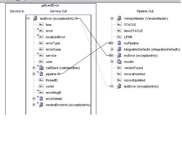

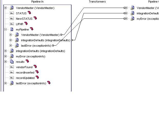

  • 16.  RE: Why should a *startTransaction* go outside a *Try/Catch* block?
    Posted Wed February 28, 2007 11:40 PM
    Can you post screen shots of your getLastError and rollbackTransaction calls?
    Given what you described, the transaction may appear in Developer to be rolled back but at runtime it isn’t because startTransaction (and its field, transactionName) won’t exist at the root level in the pipeline. In other words, your catch block may not be working the way you expect.
    #webMethods
    #Flow-and-Java-services
    #Integration-Server-and-ESB
  • 17.  RE: Why should a *startTransaction* go outside a *Try/Catch* block?
    Posted Thu March 01, 2007 10:19 PM
    Here are the screen shots:
    1. startTransaction in try block. transactionName is the currentDateString
    2. rollbackTransaction in catch block.
    #webMethods

  • 20.  RE: Why should a *startTransaction* go outside a *Try/Catch* block?
    Posted Thu March 01, 2007 10:34 PM
    The screenshots don’t show everything, so I can’t tell if the service is mapping the startTransactionOutput record from the lastError/pipeline. If it is, then the catch block will function as you are expecting. If you are not mapping startTransactionOutput from the lastError/pipeline document, then the call to rollbackTransaction is doing nothing because rollbackTransactionInput/transactionName will be null.
    #webMethods
  • 21.  RE: Why should a *startTransaction* go outside a *Try/Catch* block?
    Posted Thu March 01, 2007 11:00 PM
    Attached are the screen shots for getLastError and rollbackTransaction.
    Is this the right way to rollback a transaction in catch block if we start the Tx in try block?
    #webMethods

  • 24.  RE: Why should a *startTransaction* go outside a *Try/Catch* block?
    Posted Mon March 05, 2007 05:14 PM
    Almost right. Instead of this:
    pipeline
    …transactionName
    The mapping from the source var needs to be:
    pipeline
    …startTransactionOutput
    …transactionName
    #webMethods
