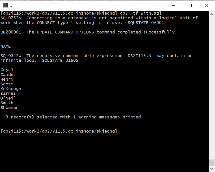

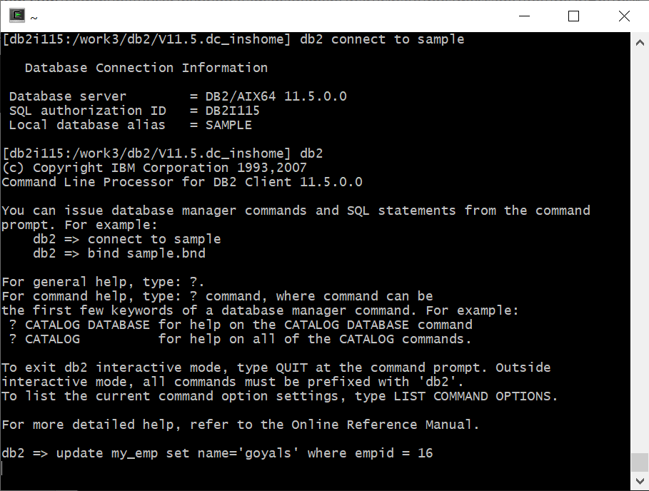

    I did a SELECT statement using CTE and CONNECT BY in one session, and executed an UPDATE in the other session.
    <Test case 1>
    1. Running recursive query (CTE) with auto-commit off
    2. The update operation works fine.

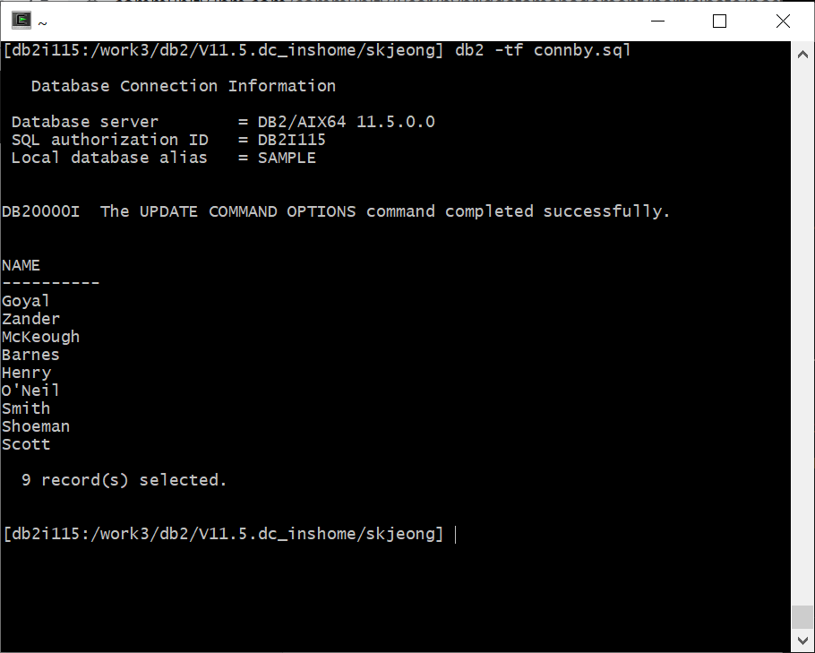

    <Test case 2>
    1. Running recursive query (CONNECT BY) with auto-commit off
    2. The update operation waits for a lock. (lock caused by select statement using connect by clause)
    This seems to be the original behavior rather than a defect.
    Is there a only way to use CTE instead of CONNECT BY clause to improve the concurrency of other SQL statements?

    -- with.sql
    connect to sample;
    update command options using c off;
    WITH n(empid, name) AS
     (SELECT empid, name
     FROM my_emp
     WHERE name = 'Goyal'
     UNION ALL
     SELECT nplus1.empid, nplus1.name
     FROM my_emp as nplus1, n
     WHERE n.empid = nplus1.mgrid)
    SELECT name FROM n
    -- connby.sql
    connect to sample;
    SELECT name
      FROM my_emp
      START WITH name = 'Goyal'
      CONNECT BY PRIOR empid = mgrid
