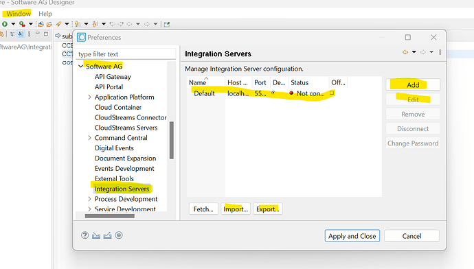

  • 2.  RE: Where is the location of the config files for IS servers in Designer?
    Posted Wed October 25, 2023 10:48 AM
    Hi Pedro.
    On Designer, on the top, go to Window / Preferences / Software AG / Integration Servers.
    There, you can mention the hostname and port of your IS, so it will be connected to your Designer. You can also import/export IS config.
    Best regards

  • 3.  RE: Where is the location of the config files for IS servers in Designer?
    Posted Thu October 26, 2023 03:45 AM
    Thank you, that was immensely helpful.

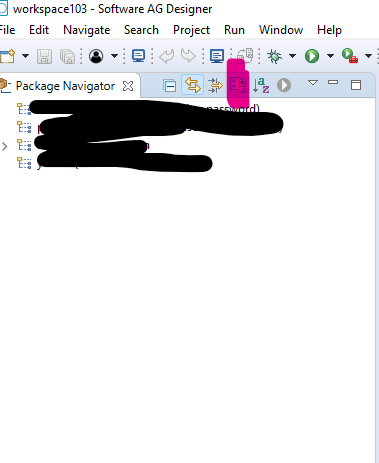

  • 4.  RE: Where is the location of the config files for IS servers in Designer?
    Posted Wed October 25, 2023 11:13 AM
    You can also click this tiny button in the picture below
    Additionally, you can check the document for more information. Documentation is pretty comprehensive.
